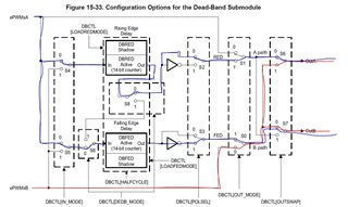

  • Also, if I enable a complementary pair using PWM1 channel A with a deadband of 400nS, I see what appears to be some noise being propagated between the two output channels. Every rising edge of one PWM signal causes a 4 - 8nS glitch on the opposite channel as shown.
    Here is my initialization code for this condition:
    // Up count
    gEPwmPhaseARef->TimeBaseCtrl.bit.CounterMode = 0;
    // Set cycle freq to 20KHz
    gEPwmPhaseARef->TimeBaseCtrl.bit.TbClkDiv = 0;
    gEPwmPhaseARef->TimeBaseCtrl.bit.HsTbClkDiv = 0;
    gEPwmPhaseARef->TimeBasePeriod.bit.Period = 2499;
    // Shadow load on period event
    gEPwmPhaseARef->CountCompCtrl.bit.ShadowAMode = false;
    gEPwmPhaseARef->CountCompCtrl.bit.LoadAMode = 1;
    gEPwmPhaseARef->CountCompCtrl.bit.LoadASync = 0;
    // Set duty cycle to 50%
    gEPwmPhaseARef->CountCompA.bit.Comp = 1249;
    // Set low on comparator A up count period event / Set high on zero event
    gEPwmPhaseARef->ActionQualACtrl.bit.CompAUp = 1;
    gEPwmPhaseARef->ActionQualACtrl.bit.Zero = 2;
    // Reset the count and phase direction
    gEPwmPhaseARef->TimeBaseCtrl.bit.PhaseDir = 0;
    gEPwmPhaseARef->TimeBaseCount.bit.Count = 0;
    // Force channel B off
    gEPwmPhaseARef->ActionQualContSoftForce.bit.ContSoftForceB = 1;
    // Deadband shadow load mode on period
    gEPwmPhaseARef->DeadBandCtrl2.bit.ShadowBCtrlMode = true;
    gEPwmPhaseARef->DeadBandCtrl2.bit.LoadBCtrlMode = 1;
    gEPwmPhaseARef->DeadBandCtrl.bit.ShadowFedMode = false;
    gEPwmPhaseARef->DeadBandCtrl.bit.LoadFedMode = 1;
    gEPwmPhaseARef->DeadBandCtrl.bit.ShadowRedMode = true;
    gEPwmPhaseARef->DeadBandCtrl.bit.LoadRedMode = 1;
    // Set deaband to 400nS
    gEPwmPhaseARef->DeadBandRed.bit.Delay = 20;
    gEPwmPhaseARef->DeadBandFed.bit.Delay = 20;
    // Output complementary pair on Channel A / B
    gEPwmPhaseARef->DeadBandCtrl.bit.InputMode = 0;
    gEPwmPhaseARef->DeadBandCtrl.bit.OutputMode = 3;
    gEPwmPhaseARef->DeadBandCtrl.bit.OutputSwap = 0;
    gEPwmPhaseARef->DeadBandCtrl.bit.PolaritySel = 2;
    // Enable EnableEpwmTbClock
    EPwmModule::InitializationFinished();
    If it helps, the blue path shown below is the configuration I have the deadband submodule in based on the above initialization code.
    Are these just an artifact of PWM signals routed next to each other and I'll need to filter out in hardware? Or is this an issue in software?
    Thanks!
  • Hi Braden,
    I don't see anything wrong with how you have setup the software. I even ran your exact configuration and I didn't see any issues:
    Correct frequency, no glitches
    Closer view for 400nsec deadband

    I would check to see if this is a hardware issue. If you can, probe the pin coming out of the device.
    Marlyn
  • Hi Marlyn,
    Looks like it was just a product of my logic analyzer probe setup. Using an O-scope I can see that there are no glitches.
    Thanks for the help!
