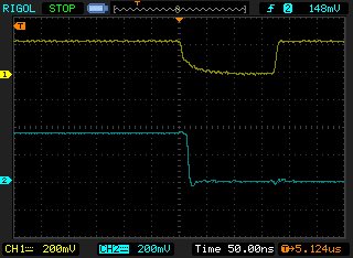

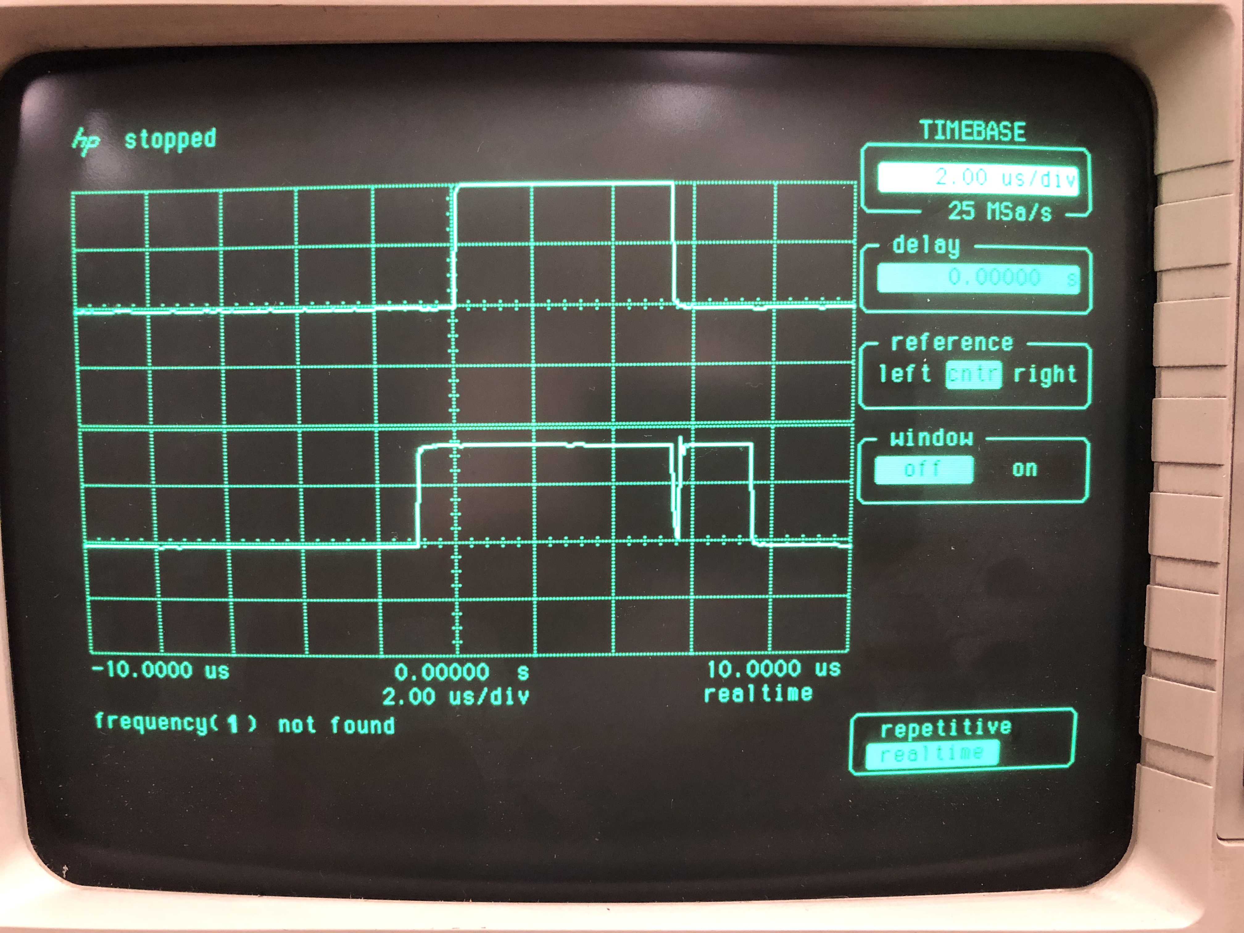

TMS320F28377S: EPWM w/deadband, one clock glitch at the beginning of Falling Edge Delay
Part Number: TMS320F28377S
Other Parts Discussed in Thread: TMS320F28388D
I believe this is some kind of chip's idiosyncrasity that I have tried to fix programmatically but was not able so far.
I am using EPWM (no HRPWM) with deadband, using ePWMxA as input to both RED and FED (twice as long as RED) and active high outputs.
When OutA falls, there is always a one clock low pulse (exactly 200nS) on OutB and then FED continues normally.
Please see picture. OutA is on top, OutB on bottom.
I tried to use separate A/B inputs, inverted inputs and outputs and anytime the output is active high, the pulse was there.
When OutB is set to active low, the pulse is not there probably because it is also low.
Any ideas what it is and how to get rid of it?
Martin

  • I have tried playing with registers but none could get rid of this pulse.
    For now I programmed output B to be complementary and then added external inverter to invert it back to positive.
    This works but makes design more complicated and is a workaround instead of a fix.
    Still looking for a confirmation from TI to what it the cause.
  • Can you post a small snippet of your epwm configuration code?
  • Here is the PWM initialization function (under development), the rest of the program controls the duty of PWM and takes care of errors.

  • I'm not sure what is causing that drop to LOW from the time that the Falling edge occurs and the delay is applied.  do you know what can cause this?
  • Can you also disable the deadband, share a picture of the signals? They should be identical, correct?

  • I see where you are coming from.
    It is true that the glitch is exactly 200 nS long and exactly at the beginning of FED delay and some clocking/race issue is suspected and I agree.
    What is interesting that it only happens with active high pulses and is not noticeable with active low even though it could be present.

    and none of them made any difference. However I zoomed in on the glitch and found the following:
    - the glitch always starts 10 nS before FED delay starts or other words before CHAN A  falls
    - the glitch is exactly 160 (most of the time) or 170 nS (sometimes)
    I think this is important information that there is 10 nS difference between falling edges which is exactly the width of the EPWMCLK and that the glitch width is 16(+1) clocks.
    Any ideas what could it be?

  • Another thing I noticed is that the glitch does not have a steep falling edge like the TTL driven signal should have.
    It seems like it is not driven but floating down (weak pull down?).
    See picture; top is the glitch (170 nS width captured), bottom is the falling edge of CHAN A pulse (reversed channels of the original picture).

  • I have disabled Digital Compare Submodule by changing the DCTRIPSEL register to an unused input and the PWM output became longer as expected but no glitch!
    I think I can conclude that it is something in DC or TZ modules.
