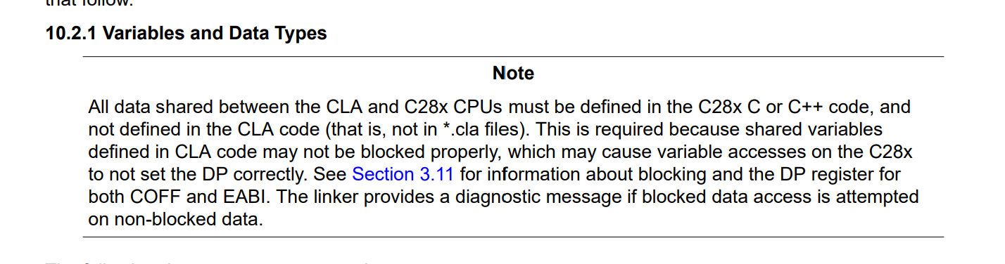

I have followed TI guidelines as mentioned in www.ti.com/lit/spru514 and made corresponding changes in my code based on these guidelines. This solution works for three boards that had CLA issues before, and now all correct values are returned when the CPU accesses variables from CLA.
However, I am facing an issue with one board. This board has no CLA issue when I define shared variables in the CLA code, but when I update the firmware to the one with shared variable definitions in the C code, it has CLA issues and returns a value of 0 in some shared variables.

    *also note that V1 is following CLA dev guide on defining shared variables in C code.

  • To update you on this matter
    1. proper initialization can solve the issue. All Cla-to-Cpu variables need to be initialized in the CLA Task.
    2. Cpu-to-Cla and DataRam can be initialized in the CPU.
    3. pointer casting to Cla-to-Cpu did not cause the issue.
