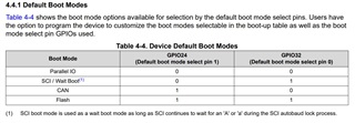

  • Emma,
                    You need to be clear on which boot-mode you are using:
    CAN boot-mode is facilitated by the DCAN module. This mode can be selected by GPIO24 & GPIO32.
    CAN FD boot-mode is facilitated by the MCAN module. This mode cannot be selected by GPIO24 & GPIO32.
    What would I need to write to 0xD00 to start the CAN bootloader on a CPU reset?
    0xD00 is just a RAM location that you can write to through CCS.

  • Thank you for the response. It looks like the example in the TI SDK utilizes MCAN
    Understand, but what is the mode you want to use? Does your application need the higher-bit-rate and payload size offered by MCAN or does the lower bit-rate/payload of DCAN would suffice?
    If GPIO4 and GPIO5 are the correct pins, how do I set them?
    You are mixing up the boot-mode select pins with pins used for the peripheral function. What Table 4-41 shows you is which GPIO pins are used for the MCAN function. This is after you have selected the MCAN boot mode.

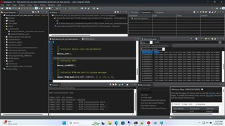

  • Thanks everyone,
    Here are the steps I am following to try and get the CAN flash programmer working:
    1. I have a project loaded on the processor. In CC I set the emulation registers to the previously recommended values
    2. I clicked on the CPU Reset button and select resume
    3. On the PC side in a command line window, I type the command given in the readme file.
    I'm using the PCAN-USB Pro FD which is also plugged into my computer and connected to the CAN HI, LO, and GND pins on the launchpad. The PEAK device USB light is blinking green, indicating a solid connection to the computer, and the CAN1 channel light is also blinking green indicating a software application is connected to the CAN interface, but there doesn't seem to be any data moving through (expecting the green LED to blink faster during a transfer of data), and the LED on the microcontroller isn't blinking meaning the LED application was not programmed to FLASH.
    If I pause CC after sending the command on the PC side. I see the following (I was trying to access the function call tree):
    It says that no symbols are defined. Could that be an issue?
    Any ideas on how to debug this moving forward or what I may be doing wrong?
    Thanks for the help!
    -Emma
  • Hi Emma,
    A few things to check:
    1. Are the Flash kernel text file and the led application file in the same location as the host programmer executable?
    2. Is the Flash kernel project and led projects set to use the LAUNCHXL-F280039C settings if using the launchpad? This must be provided as a part of the symbols for the project, as shown below. Without this being set, the LED will not be visible after download.
    3. Is the CAN routing switch on the device set low? This will allow the transfer to occur to GPIO Lo/Hi instead of the Booster pack heading.
    Pausing the CC to see that no symbols are loaded indicates that the kernel was not downloaded.
    Once the MCAN Flash kernel and application have downloaded to the device, the device boot mode can be set to Flash through the S3 boot switch.
    Posting an image of my setup as well.
    Thanks and regards,
    Charles
