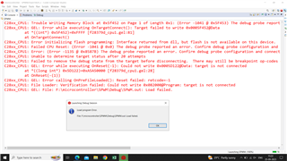

I have two issue when I upload code using OLIMEX XDS100V3 Emulator in microcontroller using TI 14pin JTAG.
1) I'm facing Sector violation (0x0 len=0x10) error while I'm uploading hex file using C2Prog.I'm also attached screenshot for your reference. As I study about this error it is something related to Linker file but I'm unable to get solution for this anywhere,how to solve this issue please provide me step by step solution.
2) When I'm using CCS for upload the code using emulator the Load program error is shown and few other error for this I attached screenshot.
I can't comment much on this error as I am not very familiar with c2prog. I will defer to the device experts on this one.
There are a lot of errors here. The one most of note is the one about flash not being available for this device. Are you using some custom F28379D board? What is the exact device being used? Provide the full name (ex: TMS320F28379DZWTT).

Hi Zaid,
1) Regarding Sector Violation error: Can you check your linker command file to ensure that all the initialized sections are mapped to valid flash address space?
2) Regarding CCS Load Program Error: Are you able to load to RAM if not to flash? Please confirm so that we can analyze further.

Hello Vamsi
1) I'm not good in backend coding I attached link for you my entire CCS project folder files including linker file for your reference, Github_link can you please check in this link, weather the linker file mapping is correct or not? or else give me suggestion how to check correct mapping
2)Yes, I tried also in RAM but still is there error.
for your reference I want to tell you the code provided in GitHub link is verified with my TI28379D launchpad and I'm able to executed code properly ,it working fine
Hi Zaid,
I reviewed your linker file - it is ok.
If you are not able to load to RAM, then it might be a board issue.
