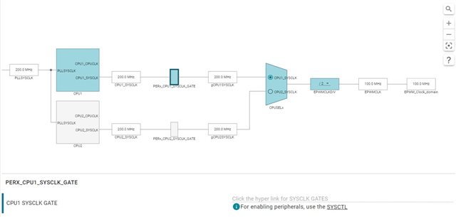

We are using CCS12.4.0 and sysconfig_1.17.0, and try to use clock tree in Sysconfig for the peripheral clock setup.

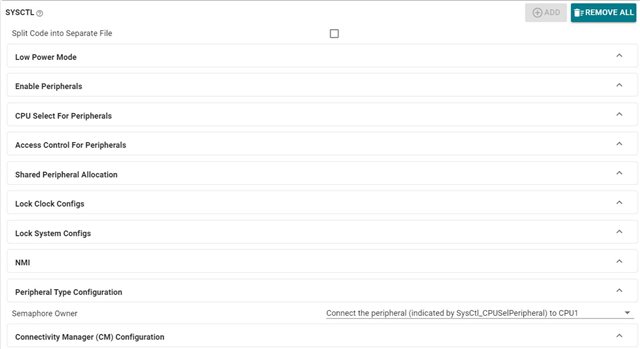

1. For EPWM clock, we want to configure EPWMCLKDIV to 1, but before reach out there, there is a configuration of CPU1 SYSCLK GATE to enable, and there is a notice for enabling peripherals, use the SYSCTL. While click the hyber link for SYSCLK Gates, I didn't see such configuration for CPU1 SYSCLK GATE. Could the expert explicitly show me the place in SYSCTL ?
  (figure 1)
 (figure 2)

  • Johnny,
    1) Each peripheral clock also has its own independent clock gating which is controlled by the CPU's PCLKCRx registers. For enabling EPWM, please refer to PCLKCR2 Register (Table 3-75. PCLKCR2 Register Field Descriptions)

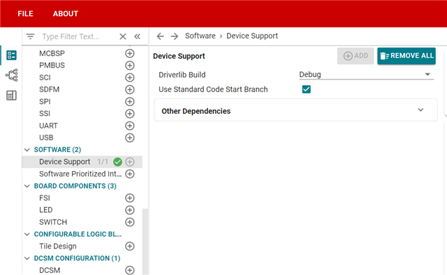

    2) To use clocktree.h, customer should enable the "device support". Then, the settings are going to be applied in device.h.
    To enable device support, you need to press this button in SysConfig.
    3) There is going to be a video explaining how to use clocktree very soon.

    1) We have already knew PCLKCR2 Register could be configured for EPWM clock by manually. I was trying yo ask how to configure PCLKCR2 Register in clock tree tool as snippet. Would you kindly show me where and how to enable PERX_CPU1_SYSCLK_GATE in SYSCTL as shown in figure 2 ?
    2) Thanks, after enabling device support in GUI, I do see the GUI generated device.c and device.h from Generated Files column.

  • Johnny,
    Unfortunately with current implementation of clocktree tool, it isn't possible to configure PCLKCR2.
    Hadi

    Any time schedule we would have this to configure PCLKCR2 in clock tree GUI ?
    Any question, does that mean I also couldn’t configure EPWMCLKDIV value in register PERCLKDIVSEL in clock tree GUI, correct ?
    Johnny
  • Hi Johnny,
    Your understanding is right. You can't configure EPWMCLKDIV value in register PERCLKDIVSEL in clock tree GUI.
    We have implemented that for F28P65x, but I'm not sure when we're going to implement for F2838x.
