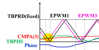

Hello I'm experiencing a duty cycle issue during the phase transition, and I would like to hear your opinions.
I'm using updown counter for all EPWM channel. The orange represents EPWM3, and the gray represents EPWM4 channels. I've set EPWM1 as a reference to adjust the phase of EPWM3 and EPWM4. In the section of the image, the duty cycle of EPWM3 is approximately d3=0.1, and EPWM4 should switch complementarily with 1-d3.
However, the issue arises in the highlighted red rectangle. The duty cycle of EPWM3 should be around 0.1, but suddenly it becomes 1 in that region. Despite limiting the duty cycle of EPWM to a maximum of 0.5, it unexpectedly reaches 1. This problem doesn't persist but occurs sporadically even though it generally operates well.
This problem seems to occur when using phase shift, and it works fine when phase shift is not applied. Moreover, during this time, when the phase transitions from positive to negative, it seems to have an impact.

  • yes it occur only some specific phase shift value. and epwm are shifted well by my phase shift value that the ouput PI controller. And i'm trying to give you scopeshot. but i'm using ccs its hard to take a photo.
    phase value updated per 20kHz(sampling frequency) and phase value is the output of PI controller. i add some photo. And i only using  synchronization when CTR=0.
  • this is phase shift value and CMPA value (bit).

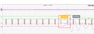

    Do you have access to be able to use an oscilloscope? I think that might be easier for you to watch the signals. What are your TBPRD and CMPx values set at and what is the EPWMCLK? (looks like TBPRD is 664?) Are you able to know what specific phase shift value the issue occurs at? Also, another setting to try is shadow loading on both CTR=0 and PRD setting.
    Allison
  • Hi Allison,
    I'll take a photo asap, and i'll show you.
    TBPRD is output of PI controller. and the value is not constant, it can move from -240 to 240. CMPA range is 66 to 332. CMPA's shape is sinusoidal. EPWMCLK is 200MHz. And my switching frequency is 150kHz.
    I want to find that value, but when I incremented the bits one by one(constant phase), there was no issue, but problems occurred when using a PI controller.
    Thank you very much. I'll try to load shadow both side.
    Song

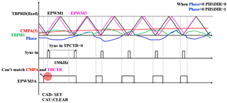

    When are you syncing to cause the phase shift? Would you be able to draw a quick diagram of what you are trying to accomplish showing the timing of when the counter = 0, TBPRD, CMPAU, CMPAD events, sync events, and when you update the TBPHS value? Sometimes the timing of these can cause issues.

    I draw diagram regarding the timing you mentioned. Is this what you were looking for?
    First, let me explain the diagram. I use up-down counter for EPWM. Black up-down counter is EPWM1 and pink one is EPWM3. EPWM3 is phase shifted by TBPHS regarding to EPWM1. And red one is CMPA and Blue one is Phase. Green one is TBPHS.
    I use fixed frequency, 150kHz. So TBPRD is fixed. I change only phase and duty cycle. But phase and duty cycle are not fixed they are variable by time and controller.EPWM3A and EPWM3B is switching complimentary. TBPHS is Full-Wave of Phase. I make TBPHS full wave of Phase (TBPHS= -Phase), PHSDIR=1 when Phase<0.  And when Phase>0 I set TBPHS=Phase , PHSDIR=0.
    While drawing it, I understood that issues related to timing could lead to duty cycle problems. When sync in, TBPHS is updated and TBCTR and CMPA could not match.  However, I'm unsure about the solution. Could you provide guidance on the next steps?

  • Hi Song,
    The diagram does help my understanding, thank you for sending. Let me know if you are able to leverage some of our existing examples or have questions there!
    How are you changing your CMPA and TBPHS values - are they updated in an ISR? Would you be able to share the code?
    My thoughts are if you are setting high on CMPA-down, clearing on CMPA-up with a changing CMPA and TBPHS, you could be missing an action qualifier. This could happen for example if your TBPHS is greater than your CMPA, meaning that when there is a sync on CTR=0, the CTR jumps to a number larger than CMPA and misses the "clear" action when CTR=CMPA. Let me also discuss with some other experts on this and get back to you tomorrow.
    Allison

  • Hi Allison,
    Sorry, but I couldn't pinpoint the exact value. The issue generally occurs with CMPA close to the minimum, around 65 in my case. At that point, TBPHS seems to be in the range of 15 to 20. However, I couldn't determine the precise value.
    I am currently setting up to monitor TBPHS and CMPA values through the scope. I will let you know shortly.

  • Hi Song,
    Thanks for getting back to me and for trying out the first methods 1 and 2. This helps us to understand that the issue is when both TBPHS and CMPA are changing. With TBPHS and CMPA values both changing, certain combinations can cause a missing Action Qualifier such as, for example, on the first cycle that TBPHS exceeds CMPA (which can cause a long PWM pulse due to the missing AQ).
    Here are some suggestions to try to resolve it:
    • Load all of your Action Qualifier settings immediately (immediate load, not shadow load)
    • Try implementing a T1 event when a your SYNCIN occurs on EPWM3 and EPWM4
      • If the count direction on a SYNC event is up and TBPHS is larger than CMPA, the T1 event should cause the same Action Qualifier that CMPA-up does.
      • If the count direction on a SYNC event is down and TBPHS is less than CMPA, the T1 event should cause the same Action Qualifier as CMPA-down

  • Hi Allison,
    I have a few questions regarding creating T1, so I would like to inquire.
    I understand "If the count direction on a SYNC event is up and TBPHS is larger than CMPA"  --> this make problem. because it make PWM turn on missing Action Qualifier. Is it right?
    And "T1 event should cause the same Action Qualifier that CMPA-up does." --> I think i have to EPWM3A turned off. So i think there will be 2 ways.
    <If the count direction on a SYNC event is up and TBPHS is larger than CMPA>
    1. Make EPWM3A forced off when sync in (can i do it? i don't know way)
    2. Make CMPA3 = TBPHS+1 (can match TBCTR with CMPA when syncin)
    which on is better way you think? Could you provide comments on it?
    And I input my code i wrote by 2. I try to make T1 in the situation what you said. I'll appreciate if you read this and provide some comments.
        int CMPA = (Uint32)((float32)ePWM_Regs[ch]->TBPRD * duty); //calculating CMPA bit
        int CMPB = (Uint32)((float32)ePWM_Regs[ch]->TBPRD *(1 - duty)); //calculating CMPB bit
        int TBPHS;
        if(phase < 0){
            TBPHS = (int16)((float32)ePWM_Regs[ch]->TBPRD * -phase * 0.00555555); //calculating TBPHS bit
        else{
            TBPHS = (int16)((float32)ePWM_Regs[ch]->TBPRD * phase * 0.00555555); //calculating TBPHS bit
        if( ePWM_Regs[ch]->TBSTS.bit.CTRDIR == 0){//down
            if(TBPHS > CMPA)
                ePWM_Regs[ch]->CMPA.bit.CMPA = CMPA;
                ePWM_Regs[ch]->CMPB.bit.CMPB = CMPB;
            else //T1 occur
                ePWM_Regs[ch]->CMPA.bit.CMPA = TBPHS+1; //complimentary switching
                ePWM_Regs[ch]->CMPB.bit.CMPB = TBPHS-2; //complimentary switching
        else if(ePWM_Regs[ch]->TBSTS.bit.CTRDIR == 1){//up
            if(TBPHS > CMPA) //T1 occur
                ePWM_Regs[ch]->CMPA.bit.CMPA = TBPHS-1;
                ePWM_Regs[ch]->CMPB.bit.CMPB = TBPHS+2;
            else
                ePWM_Regs[ch]->CMPA.bit.CMPA = CMPA; //complimentary switching
                ePWM_Regs[ch]->CMPB.bit.CMPB = CMPB; //complimentary switching
    But I didn't try because now I have no switch, I can't try anymore. I'd like to try it when I'm sure. I'll ask for your understanding.
    Song
  • Hi Song,
    Yes, this is correct. Below I also sketched a quick, simple case of how a missing action can occur (the below example has the counter count down after a sync event) similar to your sketch earlier. You can see where the red CMPAD event is skipped because the TBCTR jumps over CMPA when the green SYNC pulse occurs:
    Also apologies, yes I should have clarified that in order to implement T1 in a system where you are constantly updating TBPHS and CMPA (such as in your case), you would need to enable and disable T1 via software by comparing TBPHS and CMPA values during each period similar to what you are doing in the code you attached.
    • If the counter is counting up, check if TBPHS > CMPA.
      • If it is, then enable T1 to carry out the action of CMPAU (e.g. clear EPWM low)
      • If it is not, then disable T1 since it is not needed.
    • If the counter is counting down, check if TBPHS < CMPA.
      • If it is, then enable T1 to carry out the action of CMPAD (e.g. set EMPW high)
    Looking at your code, though, it seems you are adjusting CMPA and CMPB instead of using the T1 event. Was that intentional? I would recommend you configure the T1 event event of the Action Qualifier submodule - see TRM Action Qualifier section descriptions. You can select EPWMxSYNCI as the T1 event source. Then you can set the necessary action in your if/else loops depending on the TBPHS and CMPA. In this way, the action from a T1 event would supplement what the missing CMPA action would have done. Let me know if you need more clarification here.
    Allison
