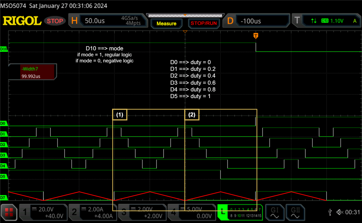

im working on a project where i need to change the PWM logic online and thats no problem, i just have to rewrite the EPwmxRegs.AQCTLA register. the problem is that i need this change to start at the time base counter when its zero, and at the moment the change occurs in between the max value and the zero when the counter is going down. this change is random and depends on the control calculations.

    I made an example to ilustrate the problem. im using ePWM 1 to 3, A and B, and asigning them a duty cycle as shown in the image.
    in the digital channel D7 i put a toggle signal so i can see when the counter of the ePWM reaches zero, and i even draw the counter. channel D10 show the compare logic, which i changed via an input. as you can se the problem is when i change the mode, the compare logic does not change at the zero counter, so right before the logic change, the pulse sequence does not end properly. i need it to end propoerly, so i need somehow write to the regiser when the counter reaches zero.

  • The problem is with channel 0 to 5 (ePWM 1 to 3, A and B).
    The expected pattern can be seen in the rectangle (1) and in rectangle (2) it can be seen that it does not finish it propoerly because the compare logic is changing in between the sampling time.
    The mode was changed using the Debug feature of Code Composer Studio 11.0.0, with the "continuos refresh" option i can modify expressions when the code is already loaded on the Launchpad. The loading setting are shadow at CTR = 0, count mode up and down. timer interrupt at CTR = 0. i have  not tried inmediate change because i need the loading occure at CTR = 0.
    Since the change i made in the variable "mode" was wrote on the D10 channel, which is ePWM6A, the shadow mode will load that change at CTR = 0, because ePWM6 is also configurated like the other ePWMs. But if i have to say when the mode really changes i would say at the dashed line at (3) in the second image.
    i would say that the change of logic happens at the instat marked by the dashed line (3), there the compare logic seems to change, and should be where the if condition code related to the "mode" variable is executed.

  • In the first picture, as i said the problem was with the six ePWMs, 1 to 3 (A and B). in the rectangle (1) you can see the propoer pattern, and once i change the compare logic, the pattern does not end properly, as you can see in the rectangle (2). I made the change of "compare logic mode" using the Debug feature of Code Composer Studio 11.0.0, with the "continuos refresh" option. I can modify expressions when the code is already loaded on the Launchpad. So i changed the variable mode from 1 to 0. The pattern (2) should look like the pattern (1) before changing the compare logic, thats what im trying to do. But that is not happening because the change in compare logic does not happen at CTR = 0.
    This change of "compare logic mode" as describe by the channel D10 does not happen at that instant. Because i needed a trigger signal for the osciloscope, i wrote the "mode" variable on the ePWM6A, this one is configurated with shadow register, so the loading happens at CTR = 0, but really the change of compare logic its happening before. Most certainly near the dashed line at (3), in the second image.
    So the change of compare logic that im trying to write in the registers of EPwm1Regs.AQCTLA is happening at the line (3) and i need some how that this change to happen at CTR = 0.

  • Baldomero,
    Thanks for the images - I can understand the issue clearly. Can you share your PWM configurations/initialization (specifically for the D4 channel that is incorrectly changing).
    It looks like all other PWM channels are changing at the correct time (or, rather, the AQ changes are shadow-to-active loaded when CTR=0 as expected) which means you should not see this AQ behavior on any of the channels until the CTR=0 event after (3). Does this issue occur every time you change the mode? Or is it only sometimes (dependent on the precise time or CTR value when you change it)?
    Allison
  • of course, D4 channel correspond to ePWM3B and is configurated like all ePWM. i have commented the definition of each value for better understanding.

    i dont think the behavior of the D4 channel is wrong, rather correct for the situation im experiencing. Because of shadow loading, it knows that at a deternuined moment of the CAU it has to do some action, which previously was "Clear", but since im changing the logic compare near the dashed line (3), now the action is "Set", so it stay the same. And then since the logic is negative, at CAD now it does a "Clear" rather than a "Set".
    I've run this test multiple times and this issue occur every time i change the mode.
