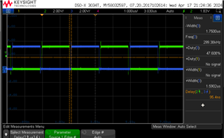

I'm trying to set specific dead band
working on HRPWM mode so dead band clock *2 rate system clock = 10 ns (100 MHz)
I want to set FED = 90nSec, so calculated the following
DBFED = FED/(2*TBCLK) = 90nSec/5nSec = 18 DBCYC
So I insert it to DBFED
But with scope I measure ~80nSec DB:
And when I change DBFED to 20 it fit to relevant DB (Every DBCYC increase in 5nSec):
Why there is 2 DBCYC offset? how can I fix that?
I was working according https://www.ti.com/content/dam/videos/external-videos/9/3816841626001/6304743885001.mp4/subassets/epwm_dead-band_submodule_slides.pdf
Thanks!
Michael
I figured that it related to D.C., When start running code on D.C. = 0.1 I got the right dead band:
When changing only CMPA that set new D.C. (without touching DB registers) so I got the DB down to 80nSec:
Also figure that CMPHR register is shifting DB for some reason:
When CMPHR = 0X0100:
When CMPHR = 0XFF00:
And again, DBFED doesn't change at all.
Another thing that I figured, that in variable frequencies of PWM (variable TBPRD) I got the same problem:
Working on freq. of 200KHz, TBPRD = 250, and DBRED DBFED like the following -
I got the following dead band
When changing freq to 300KHz TBPRD = 167 and DBRED DBFED remain the same -
Help please :)

Hi Allison,
So the main issue is dead band that doesn't accurate all of the time, I set DBRED and FED according calculation on this article:
https://www.ti.com/lit/an/sprad12a/sprad12a.pdf?ts=1713270874468 Chapter 5.
And using active high complementary mode, and the measured DB isn't like the desired DB.
I'm using all HRPWM capabilities TBPRDHR, DeadBand HR, duty.
I'm trying to achieve HRPWM A,B signals when B is complementary to A with 90nSec deadband.
I do get the required DB, but when start changing CMPAHR value for some reason DB shrink
For example, when I set default value of CMPAHR to 0x0100 and CMPA I got DB of 90nSec:
When I change CMPAHR to 0x8000 for example I got DB of 85nSec (see that DBRED DBFED doesn't change) :
And even when I change CMPAHR to 0X0A00 it got even worse (see that DBRED DBFED doesn't change):
Why ?
Thanks!
Michael
