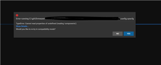

Is this a bug with the SysConfig or am I missing something?
Thank you!

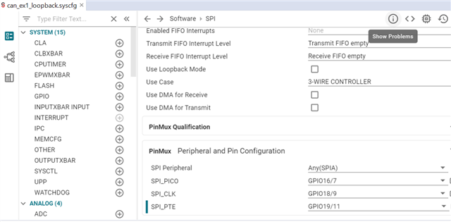

    When you open the sysconfig file in the  Sysconfig GUI , is it showing any errors or warnings that are suppressed?
    This error seems to be related to pinmux where the pin is not configured is not available .
    You can click on the "Info" icon on the Sysconfig GUI to show if any problems are reported in the configuration.
    Best Regards
    Siddharth
  • Thank you for the return.
    I just can open the sysconfig GUI using the build configuration as CPU1_RAM. Using the build configuration as CPU1_FLASH the sysconfig returns an error.
    Using the build configuration as CPU1_RAM
    I have 13 supressed warnings that I validated with the hardware specs (and the project compiles).
    On the other hand, using the build configuration as CPU1_FLASH, the sysconfig throws an error and can't open even in compatibility mode.
    edit: typo
  • Andre
    Is it possible for you to share the CCS project and the sysconfig file to take a look.?
    Best Regards
    Sididjartj
  • Sure.
