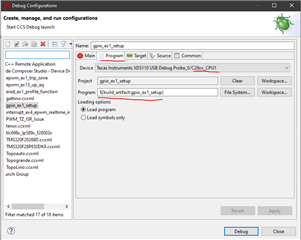

I'm studying the TMDSCNCD28P65X control card and trying to program some example code from C2000Ware_5_04_00_00 using CCS version is 12.8.1.00005
I've imported the example project: gpio_ex1_setup. And it build successfully.
But I can't load it successfully. The CCS log are shown below:

C28xx_CPU2: File Loader: Verification failed: Values at address 0x00A800@Program do not match Please verify target memory and memory map.
C28xx_CPU2: GEL: File: D:\Project\Tesseract\TI P65 test\gpio_ex1_setup\CPU1_RAM\gpio_ex1_setup.out: a data verification error occurred, file load failed.

  • Hi Jerry,
    The target configuration file seems to be trying to load to CPU2. Is this what you're trying to achieve?
    Can you double check the target configuration file settings? Ensure this is set to Active.You can right click on this .ccxml, then "Set to as Active Target Configuration".
    Double check the debug configurations by going to the following setting.
    Go to Debug Configuraitons...
    Under the "Program" Tab, ensure that the correct program is being loaded for CPU1.
    CPU2, should not be filled
    Then click on the bug icon, and try and debug your application again

  • Hi Jerry,
    Under the following red box, can you check CPU2's settings. Make sure there is no program there unless you have specified some program specifically for CPU2.
    Ryan Ma
  • Hi Ryan
    I've followed the CPU2's setting as below. (Only loaded for CPU1) And seems can be loaded into chip.

    But when I try to run the Debug, it will always jump to ESTOP0.
    Are there any other settings that I need to check?
    Best regards.
    Jerry
  • But when I try to run the Debug, it will always jump to ESTOP0.
    Hi Jerry,
    Did you add the ESTOP0? this is the software breakpoint and will halt the cpu when debugger is connected. In the original example there is no ESTOP0.
    Can you remove that ESTOP0 if you would not want the CPU to halt, instead keep the empty while loop.
    Ryan Ma
  • Hi Ryan,
    This project was from the original C2000Ware example. I didn't modify any code.
    However, once I've load the correct FW, it won't stuck at the ESTOP0. I think I might make a mistake about debug target.
    And like you said, only load FW to CPU1. CPU2 stays empty, then this example code can be execute.
