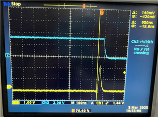

  • Hi Allison,
    I use an IO port to indicate when I disable TBCLKSYNC and when I enable TBCLKSYNC. The first image indicates that I first generate a falling edge and then enable TBCLKSYNC. The second image indicates that I enabled TBCLKSYNC first and then produced a falling edge.
    The rising edge of this graph indicates that I have disabled TBCLKSYNC, and the falling edge indicates that I have enabled TBCLKSYNC.
      As you can see from the above three graphs, I disabled TBCLKSYNC first, then configured EPWM, and finally enabled TBCLKSYNC, sharing 2.468ms. And the first EPWM waveform should have appeared after I enabled TBCLKSYNC.
      Finally, my clock rate is 120MHz, EPWM_CLOCK_DIVICER_1 and EPWM_HSCLOCK_DIVIDER_1 are set on the code. I used the company's control board to directly measure the waveform obtained from the external control of DSP. The specific process was to obtain the waveform after setting the trigger of the oscilloscope and powering on the control board. Besides, EPWM module was not configured in the BOOT, and the configuration was performed after jumping to the APP.
