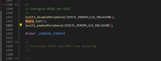

- Not able to detect sync , pwm signals for dc sync example of sdk on control card: in ethercat_dc_eepromemu_subdevice_cpu1_hal.c file , move the following configure before the launchpad definition.

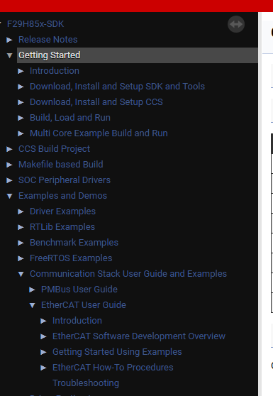

For F29H85x devices
- Docs : {f29sdk}\docs\Getting_Started.html
- Example : {F29sdk}\examples\communication\Ethercat\examples
