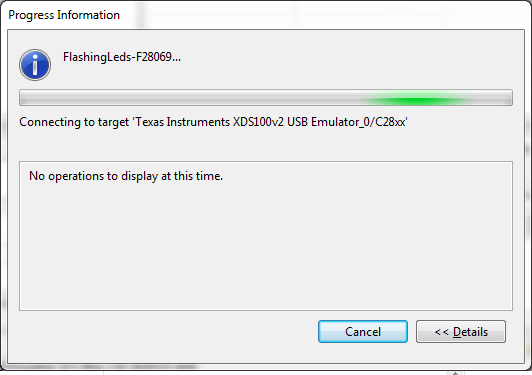

I am using a F28069 Piccolo Experimenter Kit.  I am using CC4 4.2.4.00033.
I have not had a problem until recently.
When I try to connect via the onboard XDS100v1, the target configuration file is correct (I have been using it for a month).
I get the following:
CC just hangs and continues to hang even after I hit cancel.  I have to remove power from the board for CC to “free up”.

  • Hi Brent,
    I did just notice that, according to your first post, even though xds100v1 is selected xds100v2 is being tried.  Perhaps this shows that something is just a bit off in your target configuration.  (or maybe you have a target configuration inside your project folder).  This leads me to believe we're fighting a CCS issue.

  • Hi Brett,
    Good catch on that.  Thank you for following up.  I cleaned out the project and work space, then created a new target configuration file.
    I have been launching the project in the following way (NOTE: the 28027 flashing LED project, I am not having problems with):
    1) While in C/C++ perspective, I hit the debug button at the top.
    With the now cleaned up project and launching this way, I still see the same issue.  Specifically it stays stuck on the Progress Information pop up (this is using the on board XDS100 emulator).

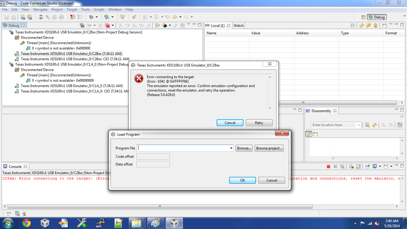

    Hitting the cancel button does not help.  I have to remove power on the board at which point I get that Error connecting to the target (Error - 1041 @ 0xFFFFFF66).

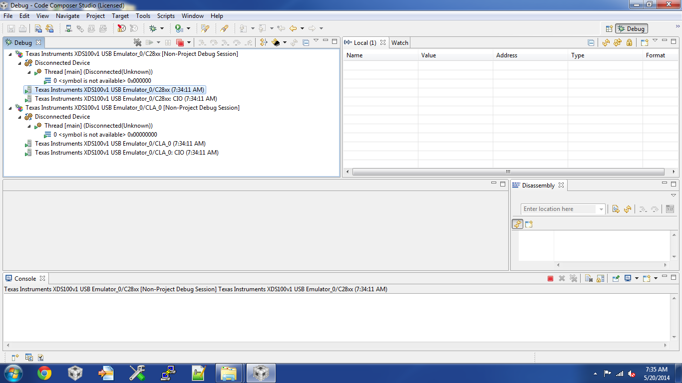

    For 1b) I see two C28xx core
    1) I try the first (i.e. right clicking and Connecting To Target).  I don't really get any feed back except when I right click again I do not have the option to connect anymore, so I continue with the next step.

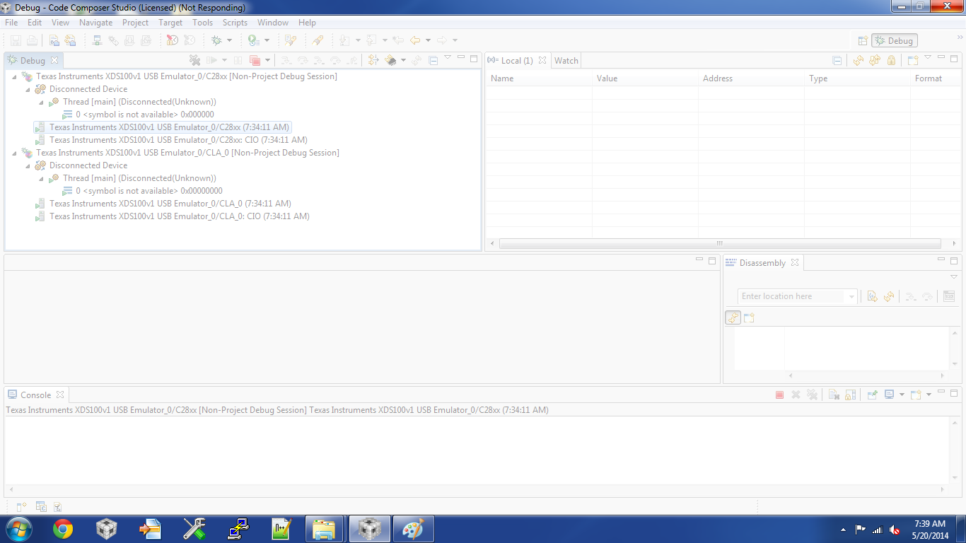

    2) Ctrl+Alt+L
    It is hanging as follows:
    Once I remove power from the board, I see the following:

  • Hi Brett,
    Trying your method a couple of more times.  Sometimes it get hung up when I do the connect, other times it will get hung up when I do the ctrl/alt/delete.
    In both instances, I do not see the device show a Connected Device.  Right below where I do right click to connect device it always shows Disconnected Device.
    Brent

    You should right-click on
      Texas Instruments XDS100v1 USB Emulator_0/C28xx [Non-Project Debug Session]
    to attempt to connect to your device.  See attached.
    (for future reference the other core you see is the CLA core)
    If successful, you should then see that the C28xx's Device's Thread should go into the "suspended" state.
    Let me know if you can get this far.

  • Hi Brett,
    Thanks for the clarification.  I tried as you asked.  I still have the same issue.  Specifically it hangs until I remove power at which point the 1041 error pop’s up.
