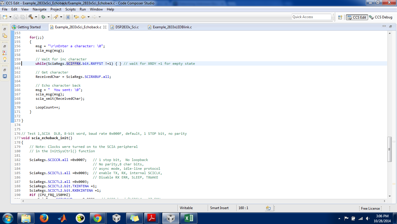

I am trying to communicate to a PC using SCI of F28335.I am currently using max232 IC as the RS-232 cable was not available for now.
We ran the echoback program given in control suite for F28069 with the same IC circuit by changing the SCIHBAUD to 0x01(earlier 0x0000) and SCILbaud to 0x03 (earlier 0x0103).It was succesfully done.we could see on the hyperterminal the sent and the recieve character.
But running echoback program for F28335 is'nt echoing back the value we are enetring. We changed the SCIHBAUD to SciaRegs.SCIHBAUD =0x01 (earlier 0x0001) and SCILBAUD to 0xE7(earlier 0x00E7).I am looking for baud rate 9600.
I can enter the character but DSP does not echoback the same.
What am I missing?

Hi Sneha,
Did you check whether the baud rate set is 9600 on DSO? Transmit some data in while loop and check the baud rate of the data transmitted.
Gautam

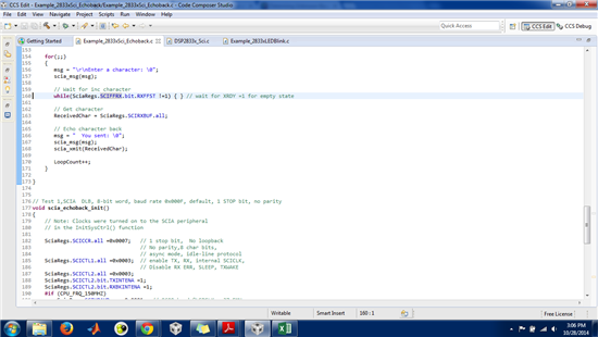

Hi Gautam
Thanks for your prompt reply.
But I am still confused.Checking baud rate on DSO?I am checking the output between Tx pin and ground.But I get nothing on DSO.And while running the program loopcount doesn't increments. it stops at line 160 as shwn in the screenshot.
Kindly guide me.
Sneha
Exactly, because its waiting at the receive interrupt. You need to remove all the receive routines and just have a sci transmit routine that polls data in a while loop, only then you'll be able to observe the data on dso.

Hi
I am not able to communicate with F28335 using SCI.I am running the SCI_Echoback program from control suite fo r F28335.But its not working.
The same program worked successfully for F28069 control stick.
I am attaching the screenshot of hyperterminal screen and the watch window.the loopcount does not increments and stucks at the line waiting for recieve interrupt.
The baud rate is 9600 set as 0001,00E7 for SCIHBAUD,SCILBAUD for LSPCLK 37.5 MHz.
Kindly help
Thank
Sneha

Hi Gautam
The problem is resolved,without connecting the ground pins.
I changes the GPIO pins.Earlier I was checking on GPIO 28 and 29 SCIA and itdidnot run.
By chnaging it to SCIB i.e. GPIO18 and 19 It worked.
