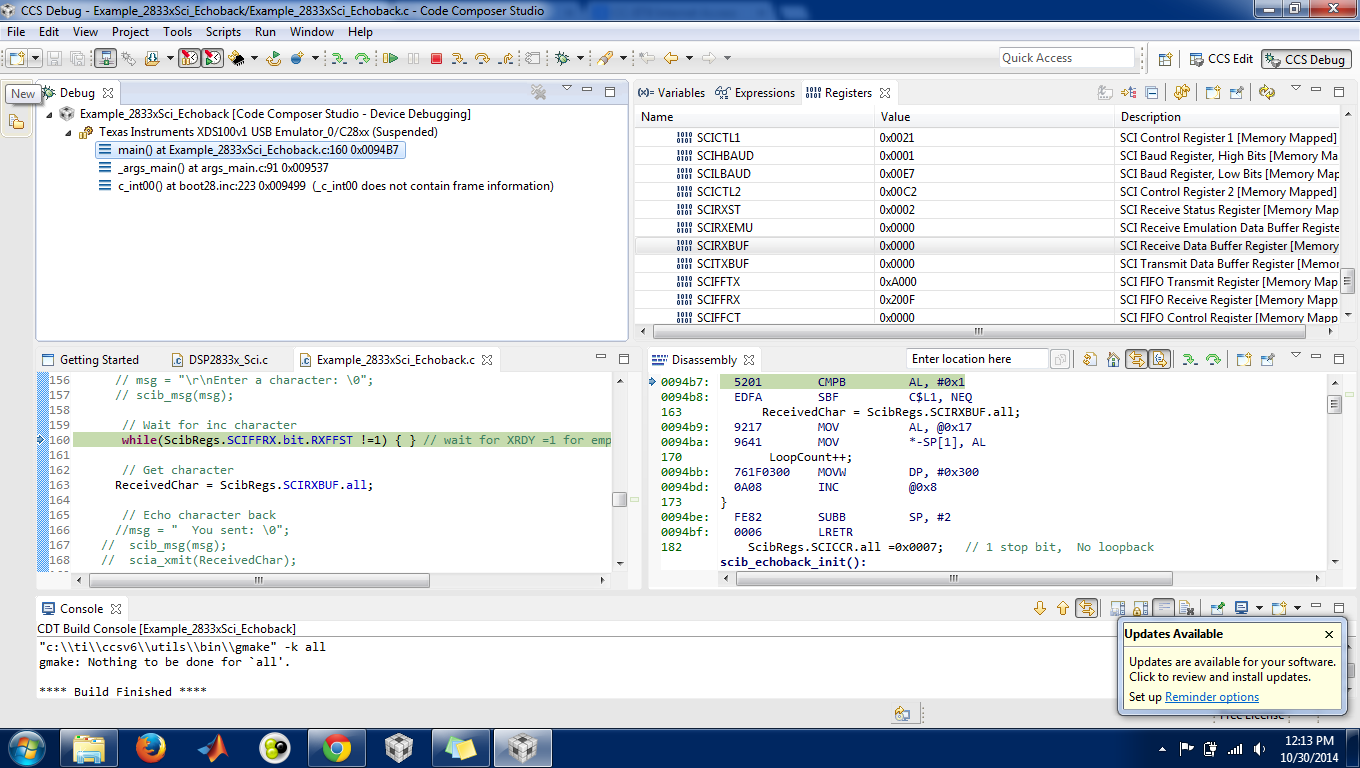

  • Hi Gautam
    As suggested by you, after matching the baud rates for both the controllers i have moved ahead with the SCI communication between the two,by connecting their Tx and Rx pins together (F28069 and F28335).
    The baud rates for both is 9600.I can see the TxBUF in the watch windowchanging values but no change in RxBUF.The code is as follows.I am missing something very important in it.Can you please help.

    2.Rx code for F28335

    //    As is, the program configures SCI-A for 9600 baud with
    //    SYSCLKOUT = 150MHz and LSPCLK = 37.5 MHz

    Sneha
  • Sneha Thakur said:
    I am using a simple wired connection between two controllers.Should there be some isolator in between or maybe some other hardware?
    As both of the controllers are 3.3V logic based, they should work with simple wires but you can once try with drivers like max3221 or max232 (just for trial). But as far as I remember I interfaced F28335 & F28027 directly without any hardware in between and they worked as charm.
    Gautam
  • HI Gautam

    This is the code being run for reciever on other end,.But when we run ,I guess its not executing at all.The screenshots of the screen before and after running the program are below:
    I am running Tx code for 28069 on one PC and then its is wired to 28335 which is connected to other PC.The Rx program for 28335 is being run on the other PC.Ground pins of both controllers are connected and TX-Rx pins too.Am I missing something?
    Please reply.
    Sneha
    I guess you're following these steps:
    1. No need to connect F28069 kit for debugging. Let the power be off.
    2. F28335 kit should be in debug mode and waiting for the data.
    3. Switch on the F28069 kit which has only single data transmission (don't use continuous polling of data as of now)
    4. Monitor Rx interrupt flag & SCIRXEMU for data on the watch window.

  • Hi Gautam
    I tried working the steps recommended by you.Enabled RxInterrupt function for Rx routinue and tried out few if else loops inside.I am gettting data in Tx BUF but not in Rx BUF.
    I tried step by step execution,but the program does not enter in the while loop,as it is not recieving any data and stops there.
     i again checked the original echoback program and its working fine,this means pins are working finr.
    Can this be the compatibility issue?Different Controllers...??
    thanks
    Sneha

  • Hi Gautam
    The problem is resolved.I was doing few silly mistakes.
    1. In Tx routinue i had not relinquised SCI from reset.I had commented it.
    2.I was calling ISR for SCIA while i was working with SCIB.
    And while observing the variables on watch window,SCIRXST =00FA...Bit 5= BRKDT = 1.
    SCI break-detect flag. The SCI sets this bit when a break condition occurs. A break condition
    occurs when the SCI receiver data line (SCIRXD) remains continuously low for at least ten bits,
    beginning after a missing first stop bit. The occurrence of a break causes a receiver interrupt to be
    generated if the RX/BK INT ENA bit is a 1, but it does not cause the receiver buffer to be loaded. A
    BRKDT interrupt can occur even if the receiver SLEEP bit is set to 1. BRKDT is cleared by an
    active SW RESET or by a system reset. It is not cleared by receipt of a character after the break is
    detected. In order to receive more characters, the SCI must be reset by toggling the SW RESET bit
    So I just  switched on the Tx first and then the reciever.Hope What I am thinking is right?
