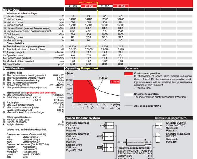

I am part of a team working in a project to control a BLDC motor which electrical characteristics are shown in figure below:
We are using the CSS and the GUI Composer to code and program the BOOSTXL-DRV8301 hardware connected to the C2000 Piccolo Launchpad. Our problem is that we cannot reach the nominal speed with no load of our BLDC motor, indicated inside the dashed yellow rectangle of the picture above.
We started by connecting our motor to the kit and run the GUI Composer to identify the motor dynamic. The Gui Composer identified the KPs and KIs motor parameters and when we set the desired target speed (16,900 rpm) the GUI Composer shows us that the motor has reached only 6,800 rpm. We then connected a Tacometer to our motor to measure the real speed and to our surprise the measured speed was around the double, 13,672 rpm.
How can we reach the 16,900rpm we want to? What are we missing? Should we change directly at user.h file with different values for USER_IQ_FULL_SCALE_FREQ_Hz, USER_IQ_FULL_SCALE_VOLTAGE_V, USER_VOLTAGE_FILTER_POLE_Hz e USER_PWM_FREQ_kHz?

  • never mind, I misread the current on the datasheet.
    5A nominal and 2-2.5 continuous under load is fine for this board....70A start-up?  That is really strange...really?

    #define USER_MOTOR_TYPE                 MOTOR_Type_Pm
    #define USER_MOTOR_NUM_POLE_PAIRS       (2)
    #define USER_MOTOR_Rr                   (NULL)
    #define USER_MOTOR_Rs                   (0.17)
    #define USER_MOTOR_Ls_d                 (0.000015)
    #define USER_MOTOR_Ls_q                 (USER_MOTOR_Ls_d)
    #define USER_MOTOR_RATED_FLUX           (0.003)
    #define USER_MOTOR_MAGNETIZING_CURRENT  (NULL)
    #define USER_MOTOR_RES_EST_CURRENT      (2.0)
    #define USER_MOTOR_IND_EST_CURRENT      (-2.0)
    #define USER_MOTOR_MAX_CURRENT          (10.0)
    #define USER_MOTOR_FLUX_EST_FREQ_Hz     (60.0)
