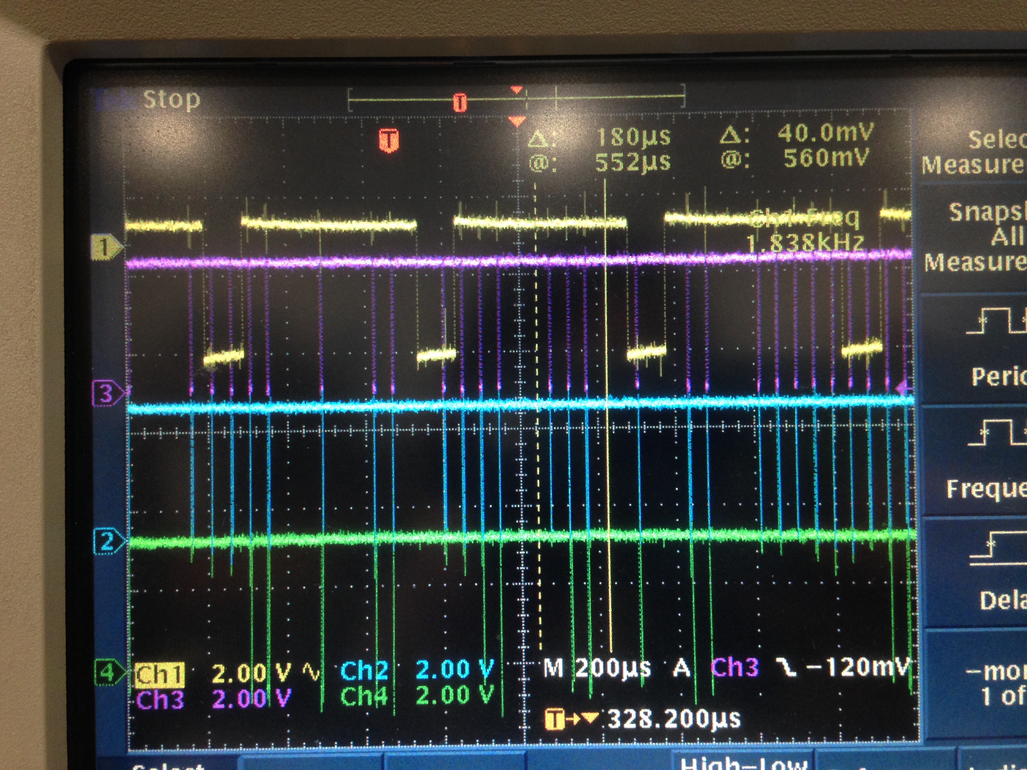

The problem is, when F28069 transmit data to Beaglebone, it sends several 0xFFFF between each data and there is no pattern. An oscilloscope screen shot is shown below, Channel 1 is the CSbar signal of SPIB which interact with the ADC, Channel 2 is CS bar of SPIA, which is sent from Beaglebone to F28069, Channel 3 is the SPI clock to F28069, and Channel 4 is the data sending from F28069 to Beaglebone.
As you can see, from some of the periods, while the CSbar and clock are sent correctly, the SOMI signal, which is suppose to have a data, is still 0xFFFF.
