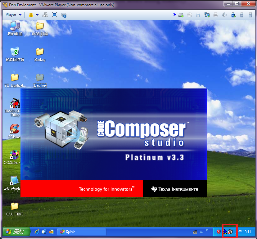

  • Thanks for replying
    When I build my project, I will get a warning message:
    warning: creating ".sysmem" section with default size of 0x400; use the -heap
                           option to change the default size.
    And I meet an embarrassing problem that I can't open my CCS3.3 now.
    When I open CCS, it will get stuck at the splash after long time waiting, the icon of CCStudio Monitor will gray out.
    I installed the CCS on WinXP SP3 on VMware Player v6.0.4.
    Is there any suggestion to fix this?

  • Yes, you need to increase the heap size.
    As for your Splash screen issue check: e2e.ti.com/.../50284
    Gautam
  • Hello Gautam
    Thanks for your replying.
    I succeed to open CCS by disconnecting my ICE(BH-USB-560v2) from my computer. Looks strange but it works...
    As suggested by Christopher, the illegal_ISR problem is solved after I give more space to .esysmem.
