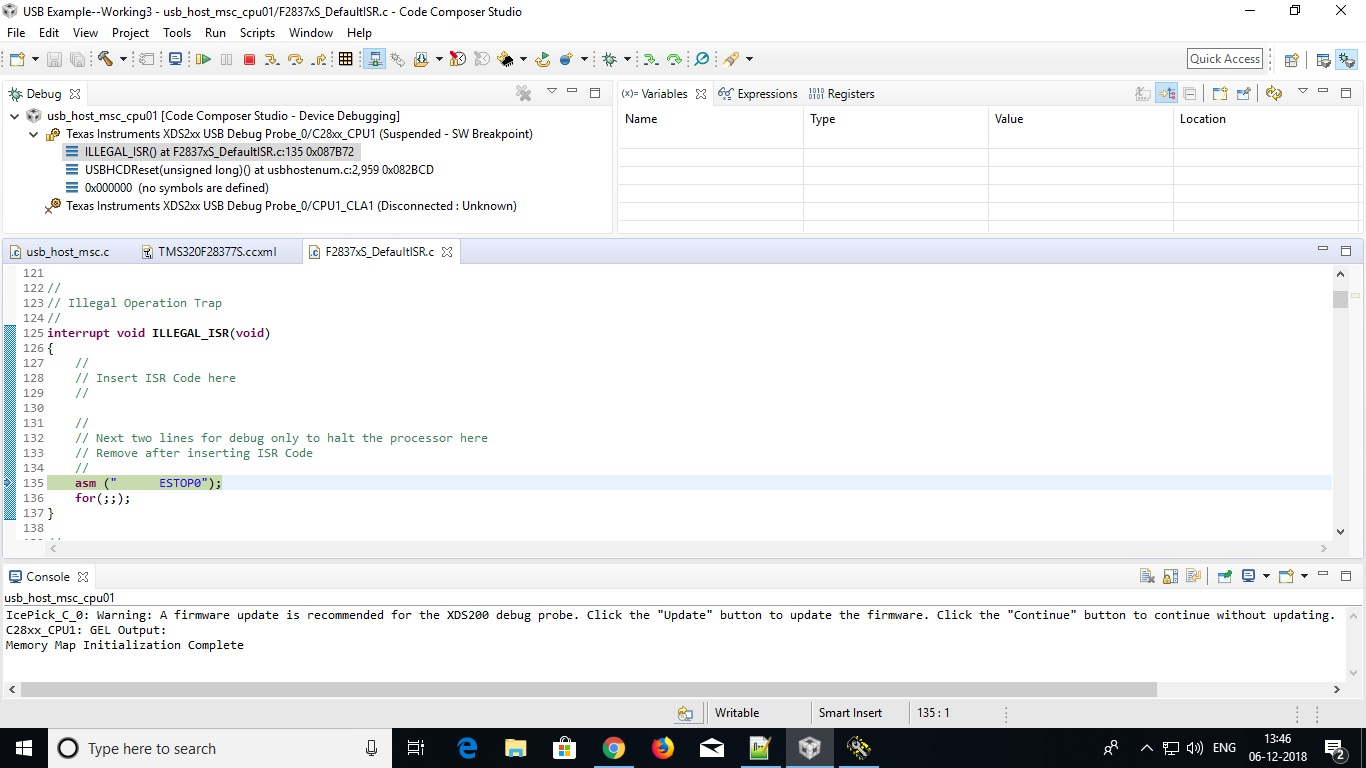

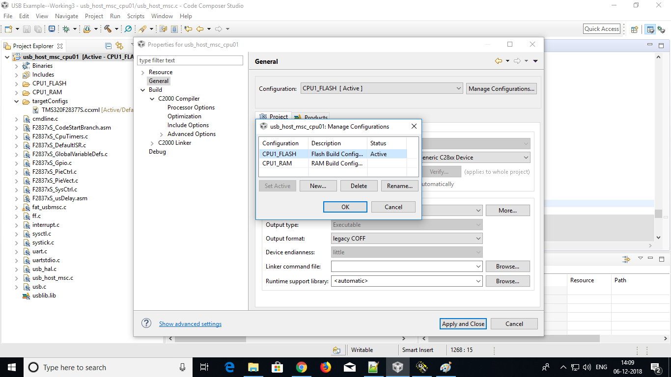

I am using TMS320F28377S processor and I want to run example code "usb_host_msc" from flash. I run this code from RAM and it is running properly. But when I select FLASH from activity configuration (image 1) and run code then program trap in to "ILLEGAL_ISR" (image2).
By step debug, I found program run up to  "ReadLine" function in "while(1)" and then it go in to "ILLEGAL_ISR". I am using CCS 8.2 and crystal frequency is 20Mhz.
