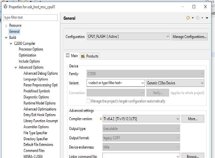

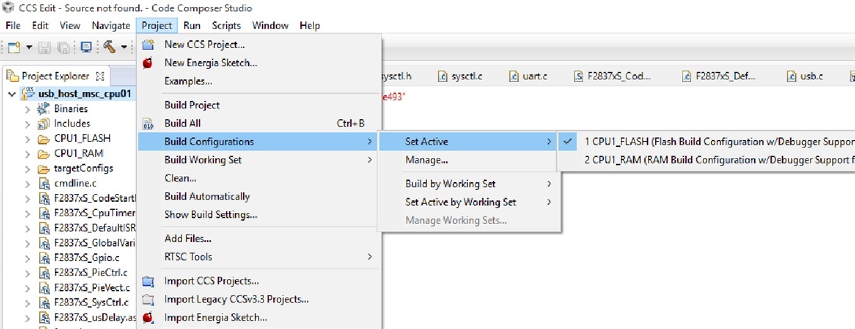

I am running example "usb_host_msc" from RAM and it is running.
But when I try to run it from FLASH it go in to illegal isr. I select FLASH from property-> general-> configuration->CPU1_FLASH-> SET_ACTIVE-> OK.
I also try to put "_FLASH" in predefined symbol --but it is not working.
when I run step by step debugging and I find out it is trapped in ISR after "USBHCDInit" function.
I want to use this code in to my project and it is running from FLASH. So please help ti solve this.

It appears you did everything you needed to convert to flash. I see you modified the divider for the Aux clock. This is good. It needs to run at 60MHz.
Why do not have the SYSCLK running at 200MHz? Why did you leave the divider at 2? The controlCard examples expect an XTAL of 20MHz, so you can drop the SYSCLK divider to 1.
Are you getting any ocmmunication from the SCI? Have you confirmed this is running properly from RAM with this clocking and SCI configuration. What if yo uchange the divider of SYSCLK to 1 and have the device run at 200MHz, does that change anything?

1. Why did you leave the divider at 2? The controlCard examples expect an XTAL of 20MHz, so you can drop the SYSCLK divider to 1----I tried this, but microcontroller not recognize the pen drive.
One more chang I made is "#define SYSTEM_CLOCK_SPEED 20000000", I not mentioned this in my previous post.
2. What if you uchange the divider of SYSCLK to 1 --Microcontroller not recognize the pen drive. Message are coming form serial port but when I try to give command like "help", microcontroller not respond.
2. Why do not have the SYSCLK running at 200MHz? --I am working on motor control and this is the CPU frequency at which my project is running. And I can't change this.
3. Have you confirmed this is running properly from RAM with this clocking and SCI configuration. --Yes, please see screenshot.
But I not understand, If program is running from RAM then why it is not running from flash?.even when every thing is same.
