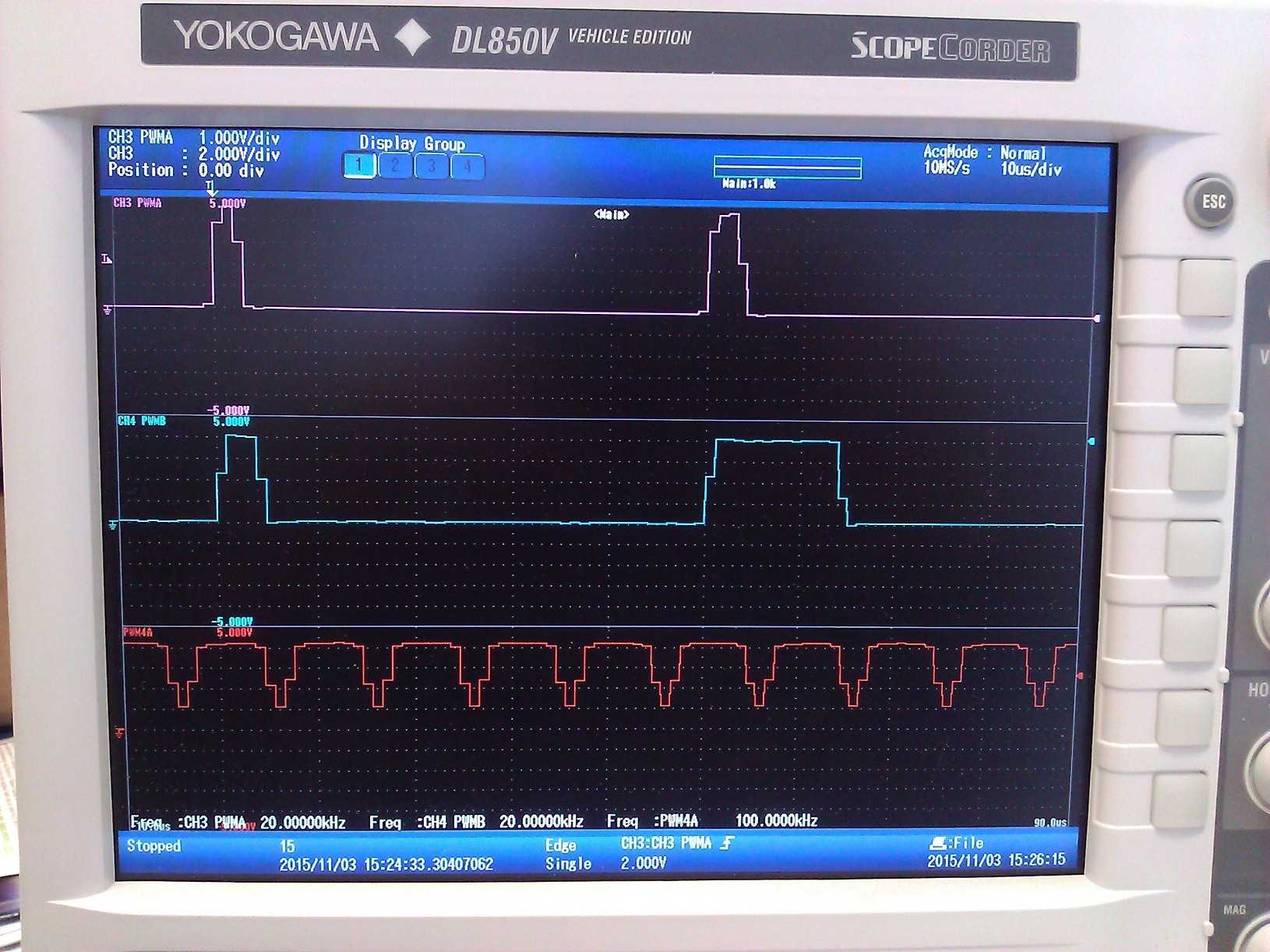

I'm encountering an unusual behaviour with the CBC trip zone and its operation on EPWMxA and EPWMxB
My code is configured to detect an overcurrent by using the ADC to sample several times within a PWM period and if the current is in excess of a threshold to trigger the CBC tripzone.
In general this is working well but I am noticing an unexplainable difference in the way it triggers PWMxA and PWMxB every now and then.
Ok, so looking at the outputs below, trace 3 is PWM1A and trace 4 is PWM1B trace 5 is concurrent with the SOCB trigger to sample the currents.
PWM1A is operating at 20kHz and the ADC sample rate is 100kHz. . The first response is pretty much as it should be, both PWM1A and PWM1B are going high, the overcurrent is being detected on the first sample and both are shutting down with the CBC trip zone event that is sent to PWM1. This is pretty much the way it is for most cycles. Occasionally you get on like the second pulse set and for some reason PWM1B seems to hang on until presumably there is a second trip zone trigger.
Any ideas as to what might be causing this?
The interrupt that triggers the CBC event is included below.
regards
steve

  • Hi Steve,
    Can you share the EPWM module configuration code as well?
    Since you are forcing the CBC event from software i would expect both A and B outputs to be impacted in the same way.
    -Bharathi.
