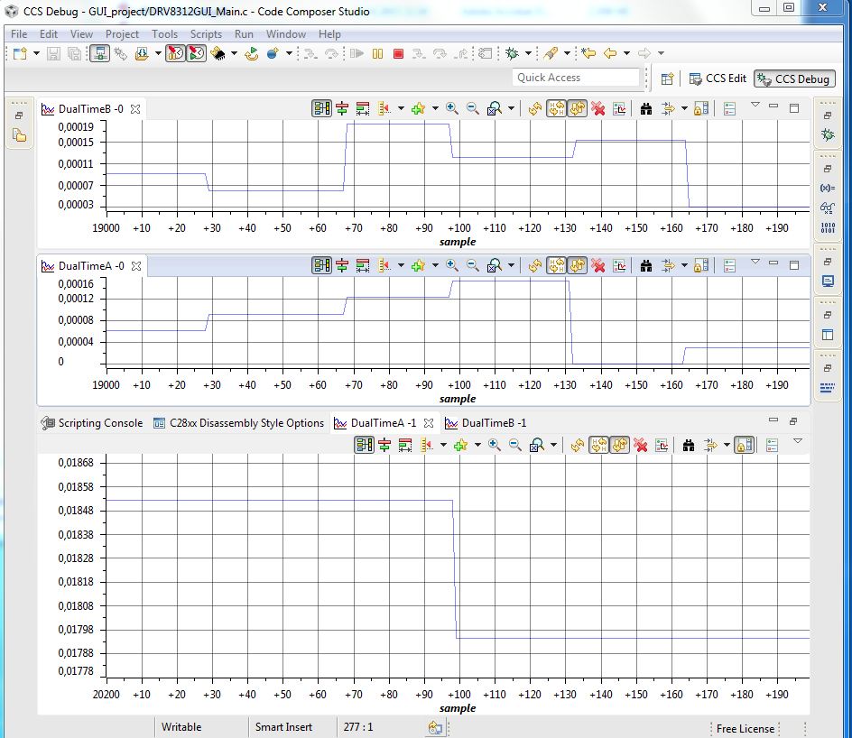

I am testing a DRV8312-C2 Kit. Using the DRV8312GUI_Main.c, is there a way to set the target Motor Speed similar to the one in DRV8312 -EVM GUI?
Running the code in CCS, I see that the SpeedRPM is a calculated value which after enabling the motor, the speed is about 600 RPM (similar to the minimum speed setting in the GUI).
I am new on working with BLDC motors and hall sensors.  Appreciate any feedback.

  • I have used the graphing Tool  from CCS to capture 3 variables:
        DlogCh1 = bldc_pwm1.CmtnPointer;
       DlogCh2 = hall1.HallGpioAccepted;
       DlogCh3 = Gui_SpeedRPM;
    I am trying to understand the scale on both axes.
    The ISR_Frequency for the BLDC Sensored is set at 20 kHz. That means one unit in x-axis (i.e. 1 sample) is taken every 50 microseconds.
    How about the y-axis? How do I interpret the levels? For the A-0 and B-0 graphs, i am expecting values of 0-5.  For the A-1 Graph, based on the value of Gui_SpeedRPM from the watchlist, it corresponds to about 600 RPM (595 RPM from the screenshot).
