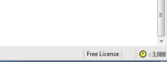

Testing the Solar library lib , specifically, the 1 phase PLL in IQ format, I am getting excesive running times, I measured with the clock utility and have obtained an average of 3000 cycles to execute the calculation function , when according to the document accompanying the library it should be around 300 cycles , does anyone know what could be the reason ?, I also noticed excessive times in the 069 using fpu , thanks in advance .

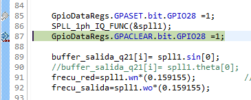

  • David, one exercise I would like you to conduct. Simply toggle a GPIO before and after this function call. Do let us know what you observe and does it match with the clock profiler data.

    As you asked me , I made the experiment , the results are consistent with what I stated in the first post ,see attached images, the time of the pin is 50.8 uS , the measured cycles are 3088 , having set the clock to 60MHz , 3088 / 60000000 , which is 51.4 uS near to pin time , I have also found that the refresh time of the associated timer (where the function is called), is correct to the configuration, 10ms .
    Time consumed in function plus 1 pin switch
    Clock cycles
    Code fragment
    Time betwwen calls, Timer 2 refresh time
