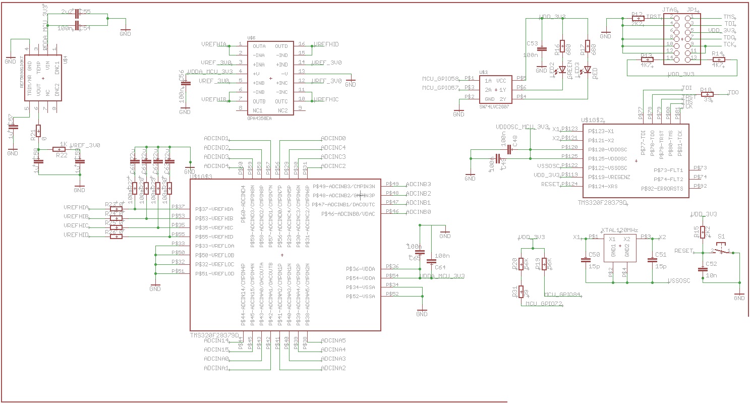

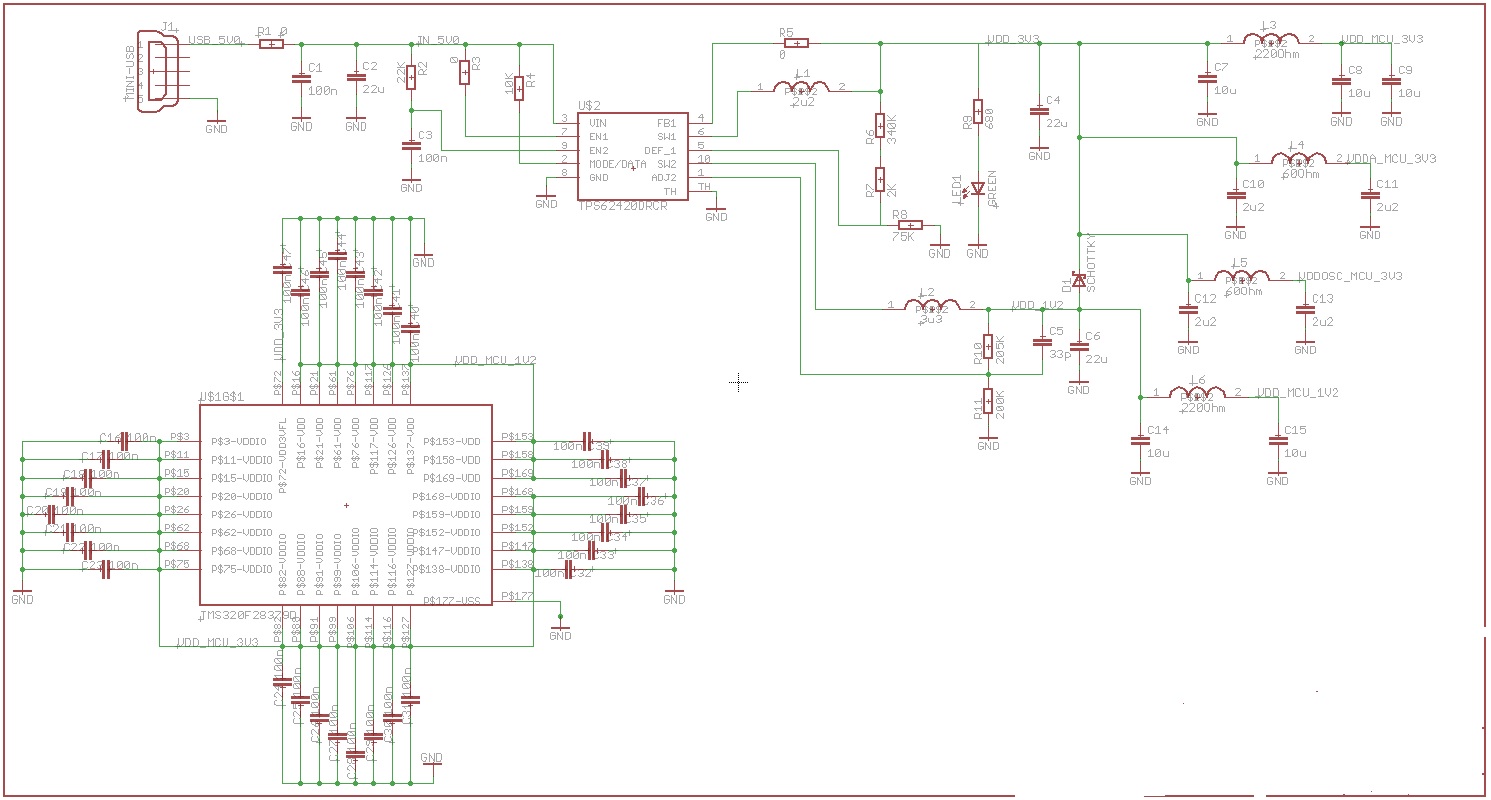

I have made a target board for TMS320F28379D based on the controlCARD R1.3. And I am using XDS100V2 14-pin JTAG Emulator/Debug probe with Code Composer 6.1.2.00015.
Following all instruction on how to connect the emulator to the target board I was able to test the connection successfully (see result below).

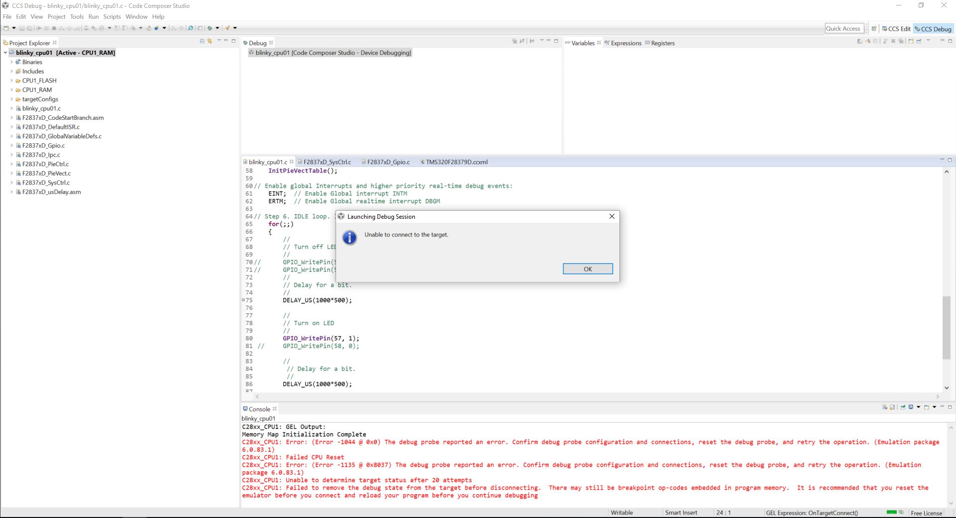

Next thing in the instructions was to "Launch Selected Configuration" and on doing that a debug session started and showed this:

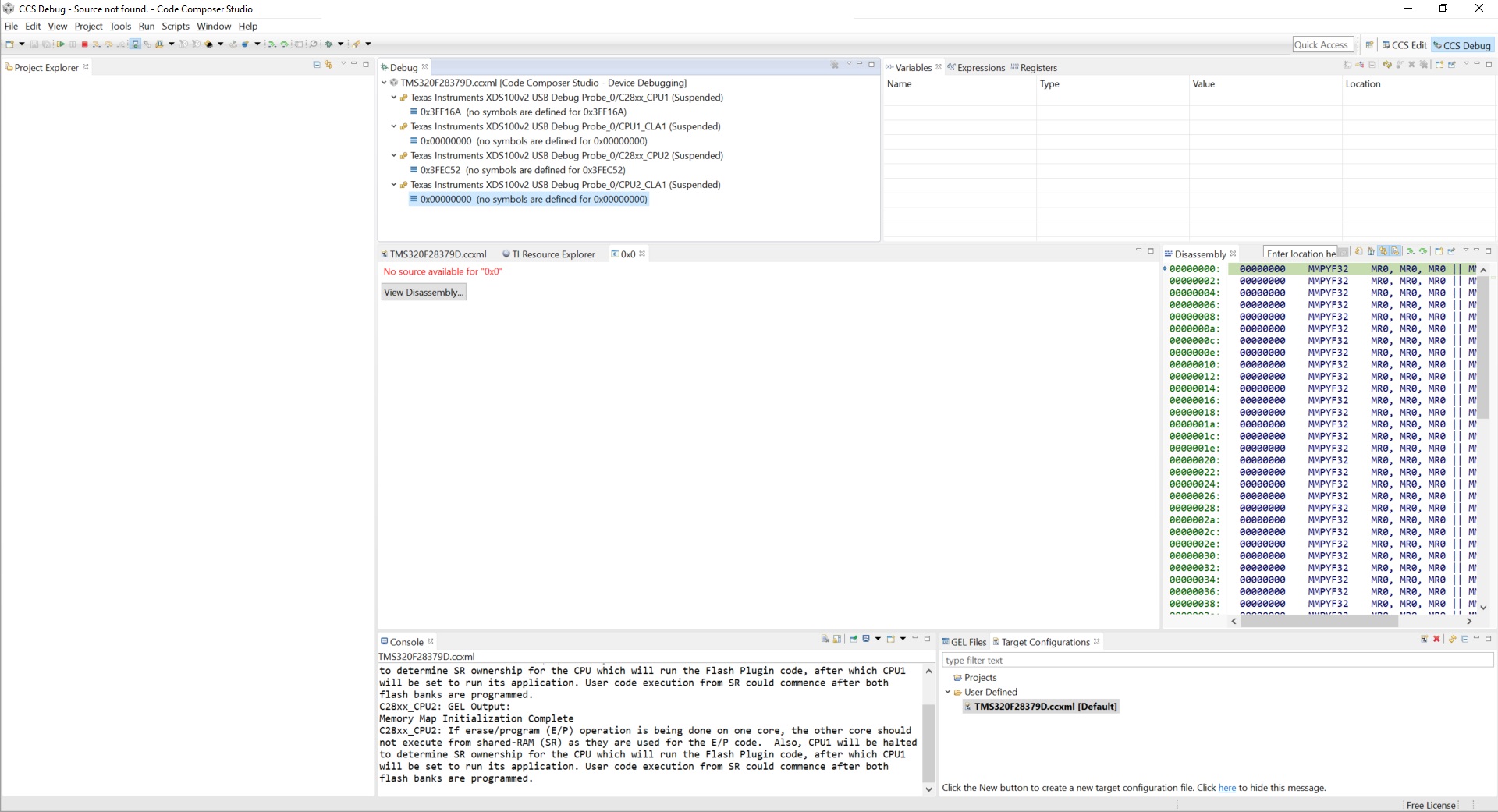

Since for all the cores it shows (Disconnected:Unknown), I right clicked each and was able to select "Connect Target" which resulted in the following:
I am using the default boot mode, that is, GPIO72 & 84 are pulled HIGH. I also have a RESET button connected to the XRS pin which is always HIGH and goes LOW when the button is pressed. The ERRORSTS pin is also LOW. I also made sure that there is continuity from the debugger on to my target board for the JTAG pins, nTRST pin goes HIGH when debug is launched otherwise it is LOW and TCK is 1MHz when the running connection test.

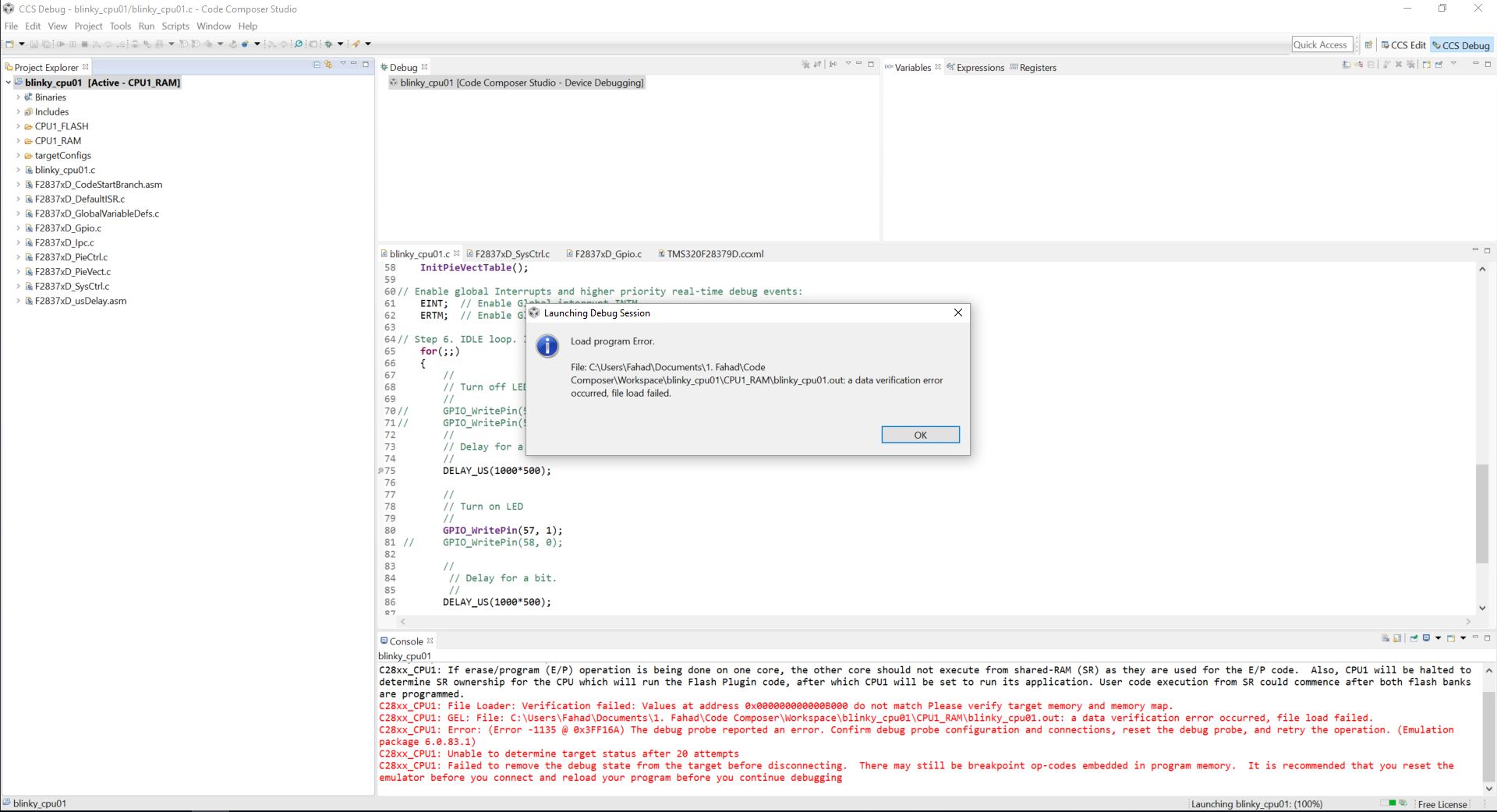

With all this done I want to now download a simple LED blink program of which there is an example in controlsuite. After loading that from controlsuite to the workspace I modified the properties of the project to use the MCU and debugger I am using. Here is what I changed:
Doing that created and made active a new TargetConfig file TMS320F28379D.ccxml. The original example had TMS320F28377D.ccxml. Now I clean/build the program resulting in 58 errors. They all seem to be Linker errors (see below). I have Set Active CPU1_RAM under Build Configuration as opposed to CPU1_FLASH. When I change to CPU1_Flash I get the same linker errors.
Can you please point me in the direction of how to go about fixing these errors?

    I made the linker file to be <none> and ended up getting NOerrors for both  Build Configurations CPU1_RAM and CPU1_Flash. When I click debug for either case, I am asked which CPU I want the program to be loaded into, CPU1 or CPU2. I chose CPU1 as it is the master.
    For CPU1_RAM configuration it seems that the program has loaded and stopped at the first line/breakpoint, waiting to RESUME. Here is what is looks like before pressing RESUME:
    After I press RESUME I get errors:
    Therefore, I stopped it and tried CPU_Flash. That too resulted in errors:
    I have checked all the power pins on the device and they have the required 3.3V or 1.2V.
    What else can I check?
    Thanks for your help
    Fahad
  • Here is the complete error I get with CPU_Flash configuration:
    C28xx_CPU1: Trouble Writing Memory Block at 0x50024 on Page 1 of Length 0x2: (Error -1044 @ 0x0) The debug probe reported an error. Confirm debug probe configuration and connections, reset the debug probe, and retry the operation. (Emulation package 6.0.83.1)
    C28xx_CPU1: Error occurred during flash operation: Target failed to write 0x00050024@Data
    C28xx_CPU1: Flash Programmer: Unable to acquire the pump semaphore. The other core might still be accessing the pump registers. Operation Cancelled.
    C28xx_CPU1: File Loader: Memory write failed: Unknown error
    C28xx_CPU1: GEL: File: C:\Users\Fahad\Documents\1. Fahad\Code Composer\Workspase\blinky_cpu01\CPU1_FLASH\blinky_cpu01.out: Load failed.
    C28xx_CPU1: Trouble Reading Register PC: (Error -1044 @ 0x0) The debug probe reported an error. Confirm debug probe configuration and connections, reset the debug probe, and retry the operation. (Emulation package 6.0.83.1)
    C28xx_CPU1: Error occurred during flash operation: Target failed to read register PC
    C28xx_CPU1: Trouble Writing Memory Block at 0x5f800 on Page 1 of Length 0x2: (Error -1044 @ 0x0) The debug probe reported an error. Confirm debug probe configuration and connections, reset the debug probe, and retry the operation. (Emulation package 6.0.83.1)
    C28xx_CPU1: Error occurred during flash operation: Target failed to write 0x0005F800@Data
    C28xx_CPU1: Trouble Writing Memory Block at 0x0 on Page 0 of Length 0x2: (Error -1044 @ 0x0) The debug probe reported an error. Confirm debug probe configuration and connections, reset the debug probe, and retry the operation. (Emulation package 6.0.83.1)
    C28xx_CPU1: Error occurred during flash operation: Target failed to write 0x00000@Program
    C28xx_CPU1: Trouble Setting Breakpoint with the Action "Remain Halted" at 0xc0e3: (Error -1044 @ 0x0) The debug probe reported an error. Confirm debug probe configuration and connections, reset the debug probe, and retry the operation. (Emulation package 6.0.83.1)
    C28xx_CPU1: Breakpoint Manager: Retrying with a AET breakpoint
    C28xx_CPU1: Breakpoint Manager: Error enabling this function: DCU_SEL Register write failed
    C28xx_CPU1: Error occurred during flash operation: Internal error while writing 0x0005F444@Data
    C28xx_CPU1: Error setting the GSxMSEL register for Flash operations
    C28xx_CPU1: Can't Run Target CPU: (Error -1044 @ 0x0) The debug probe reported an error. Confirm debug probe configuration and connections, reset the debug probe, and retry the operation. (Emulation package 6.0.83.1)
    C28xx_CPU1: Error: (Error -1044 @ 0x0) The debug probe reported an error. Confirm debug probe configuration and connections, reset the debug probe, and retry the operation. (Emulation package 6.0.83.1)
    C28xx_CPU1: Unable to determine target status after 20 attempts
    C28xx_CPU1: Failed to remove the debug state from the target before disconnecting. There may still be breakpoint op-codes embedded in program memory. It is recommended that you reset the emulator before you connect and reload your program before you continue debugging
    C28xx_CPU1: Error occurred during flash operation: Could not read 0x0007026D@Data: target is not connected
    C28xx_CPU1: Error occurred during flash operation: Could not write 0x0005F444@Data: target is not connected
    C28xx_CPU1: Error occurred during flash operation: Could not read 0x0005F444@Data: target is not connected
    C28xx_CPU1: Error occurred during flash operation: Could not write 0x0005D200@Data: target is not connected
    C28xx_CPU1: Error occurred during flash operation: Could not read 0x5D200@Program: target is not connected
    C28xx_CPU1: Error occurred during flash operation: Could not read 0x0005D20E@Data: target is not connected
    C28xx_CPU1: Error occurred during flash operation: Could not write 0x0005D20E@Data: target is not connected
    C28xx_CPU1: Error occurred during flash operation: Could not read 0x0005D22E@Data: target is not connected
    C28xx_CPU1: Error occurred during flash operation: Could not read 0x0005D208@Data: target is not connected
    C28xx_CPU1: Error occurred during flash operation: Could not write 0x0005D208@Data: target is not connected
    C28xx_CPU1: Error occurred during flash operation: Could not read 0x0005D222@Data: target is not connected
    C28xx_CPU1: Error occurred during flash operation: Could not write 0x0005D222@Data: target is not connected
    C28xx_CPU1: Error occurred during flash operation: Could not write 0x0005D214@Data: target is not connected
    C28xx_CPU1: Error occurred during flash operation: Could not write 0x00000@Program: target is not connected
    C28xx_CPU1: Error occurred during flash operation: Cannot enable while the target is disconnected
    C28xx_CPU1: Error occurred during flash operation: Failed to run target while trying to execute pwrite_dis.alg
    C28xx_CPU1: Flash operation timed out waiting for the algorithm to complete. Operation cancelled.
    C28xx_CPU1: Error occurred during flash operation: Could not write register PC: target is not connected

    I do not see anything wrong on my target board, however, just for sanity check below is its schematic for your perusal, maybe you can find something that is not correct. The design is based on the experimenter kit TMDSCNCD28379D R1.3, therefore all the components are identical.  All the GPIOs are pulled out to be connected externally to control anything else, meaning these are the only connections.
    Please let me know if anything else comes to your mind that needs to be checked.
    In the mean time I am ordering another XDS100V2 to rule out debugger problems.
  • Fahad,
    Did you notice below highlighted note from data manual (6.10 Boot ROM and Peripheral Booting @ www.ti.com/.../tms320f28377d.pdf)
    The default behavior of Get mode is boot-to-flash. On unprogrammed devices, using Get mode will result in repeated watchdog resets, which may prevent proper JTAG connection and device initialization. Use Wait mode or another boot mode for unprogrammed devices.
    Try using wait boot mode.
    Also, check for updates in CCS and install the updates (at least the ones from TI C2000 Device Support, Debug server Flash and Emulator packages).
    Our schematic expert is taking a look at your schematics.

  • Fahad,
    This is a 176-pin package. I checked Power, JTAG, Clocking and Reset – did not see any problems,
    PEter
  • Thank you Peter. I can for now rule out hardware issue :).
  • Fahad,
    There is no need to change the device variant in the project properties once you import the project from Controlsuite. Projects are setup as generic C28x projects and hence project properties should not be changed. Examples provided in F2837xD device support folder should have no issues running on F28379D.
    Once you import the project, just make sure to delete the TMS320F28377D.ccxml (right click on the ccxml file in the Project Explorer window and click on delete) and add the new target configuration file for F28379D (right click on the project -> New -> Target configuration file). No need to modify any project properties.
    Thanks and regards,
    Vamsi
  • Hi Vamsi,
    Thank you for your help with CCS. By doing what you suggested things started to work, a little :).
    What I noticed during CPU1_RAM that the code was downloaded and I can step through it (F5), however, when I ran, it crashed. Therefore, I went through the steps and found the place of the crash to be  inside InitPeripheralClocks(). For this test program I do not need any peripherals so I commented it out. By doing that the program ran like a beauty for few seconds and then crashed, however, with breakpoints in the for loop of main(), I am able to run for ever. This was all in CPU1_RAM build.
    Next I tried CPU1_FLASH build. Again without  InitPeripheralClocks(). I was able to program the MCU on one target board with USB power and another with a Power Supply. The reason I used two different power source was to see if the Dual output LDO (same as the Experimenter Kit) is receiving enough operating power. With the program running the consumed current by the target board was 110mA.
    Now is where I run into more problems. Downloading again a modified example of blinky, in either CPU1_RAM or CPU1_FLASH is not working. For CPU1_RAM I get:
    and for CPU1_FLASH I get:
    I monitored the nTRST JTAG pin. It went from LOW to HIGH and downloading crashed. Before downloading I ran the Connection Test and it too succeeded.
    I am pretty sure this MCU is not one time programmable only, right??
    Another thing I noticed between the two identical target boards is that during debug on one I can see all cores of the MCU whereas on the other I see only CPU1. Selecting "show all cores" does not do anything either.
    The program that got flashed is running without any issues. Pressing the reset button, resets the MCU and the program restarts after the button is released.
    I know removing the InitPeripheralClocks() is not a solution as it will be needed later.
    Any suggestions on what could be happening??
    Thanks for all your help.
    Fahad
  • Hi all,
    Changing to WAIT MODE has solved the repeat flashing issue.
    However, when InitPeripheralClocks() is added back into the code, I get the "operating in low power mode" error for both CPU1_RAM and CPU1_FLASH.
    Can this be because of the Dual-LDO not providing enough power to the MCU??.
    This Dual-LDO along with all its required external components are same the ones used in the Experimenter Kit TMDSCNCD28377D_R1_3.
    Fahad
  • Hi Fahad,
    I think it is possible that the reset could be from the device being current starved. Can you place a scope probe on the 5.0V, 3.3V, and 1.2V rails, as well as on the XRSn pin (trigger) while running the code?
    What is the value of the XTAL that you use in the circuit? Is it XTAL1 - 20MHz, or XTAL - 120MHz? I assume 20MHz. Have you checked the PLL settings to ensure that the device is running at 200MHz? You can also configure, and then check, the XCLKOUT pin.
    Is it possible that the "EDIS" instruction at the end of the InitPeripheralClocks() function is causing some other setting write to be missed somewhere else in the code after the function call?
  • Hi Devin,
    Thank you for your reply.
    The PLL is configured to 200MHz: InitSysPll(XTAL_OSC,IMULT_20,FMULT_0,PLLCLK_BY_2); with XTAL = 20MHz.
    So, I bypassed the LDO and now have 3.3V and 1.2V coming from a power supply. EVERYTHING is working the way it should :). Even with InitPeripheralClocks() function.
    My blinky is simple two LEDs alternating ON and OFF. See pics below. First one is Voltage settings, second shows the current. What I notice is pretty HIGH current from the 1.2V supply. 240mA is it supposed to be that HIGH??
    In any case, the LDO was not able to handle this. The Experimenter Kit uses the same LDO. Maybe my PCB design needs redoing or use separate LDOs for 3.3V and 1.2V.
    Thanks everyone for all your help.
