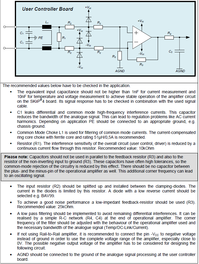

  • Hi Brett,
    As I mentionned earlier, I will have to convert not a +/-12V but a +/-10V input to the 12bit ADC (sampling rate at 10kHz). The current transducer manufacturer has some recommendations on how to design the ADC front end. I simulated a circuit with Tina V9.3 and I have a few questions:
    *You will find attached my Tina project and the recommended analog front end desing.
    1- Is it possible to add a common mode choke in the design.
    2- I try to simulate a voltage divider with splitted up input resistors between the clamping diodes. If I used splited resistors in my design the voltage gain is not set proporley. Do you know why.
    3- I used the OPA376 op amp for my design, is it a good choice for that kind of application.
    4- I used one amplifier for gain divider and one amplifier for voltage filtering. Is it a good design practice or it would be a better choice to combine both stages. If using two stages is a good design practice, do the resistors of the low-pass filter should be higher than the actual values (I used Filter Pro to design the filter, Fc = 3kHz, 2 poles, Bessel, Sallen-Key) to match the previous stage.
    5- Should I select a lower capacitor value for the passive RC filter.
    ADC_Front_End.TSC
    Best Regards
  • Hi Dany,
    This is getting deeper into the signal chain and while we may be able to provide answers to your questions, you will likely get superior answers if you post these new questions on the TI E2E Precision Amplifiers forum:
    https://e2e.ti.com/support/amplifiers/precision_amplifiers/
    They will likely be able to help you best with the opamp selection and what the best circuit topology is.  Feel free to reference this post in your post there.
    Furthermore, feel free to return to the C2000 forum if you'd like more help on the interface to the ADC (perhaps to help ensure good ADC settling with our ADC and the selected circuit).
    [Note that a model of this device's internal ADC sampling circuit can be found in the device datasheet]
