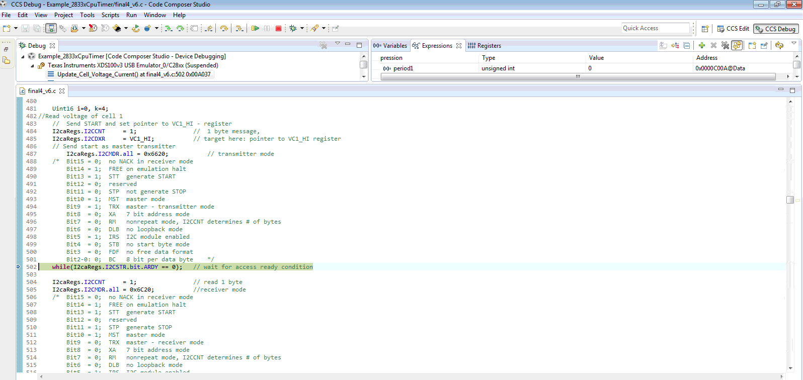

i am using an BQ76940EVM product working with DSP f28335 through I2C communcation. for purpose of using 12 cells, i already short circuit input pin 3-4, 8-9, 13-14.   sometime they work well together for a few minutes, and after that suddenly stop working, i recognize that the DSP are unable to read the BQ76940's registers. please give me solution. i'll also post my code here. thank you.

while(I2caRegs.I2CSTR.bit.ARDY == 0); // wait for access ready condition
