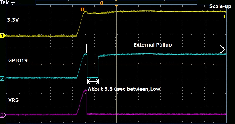

2. Immediately after turning on the power supply, it goes from "High" to "Low" and goes "High" after about 5.8 usec.
    GPIO19, GPIO34

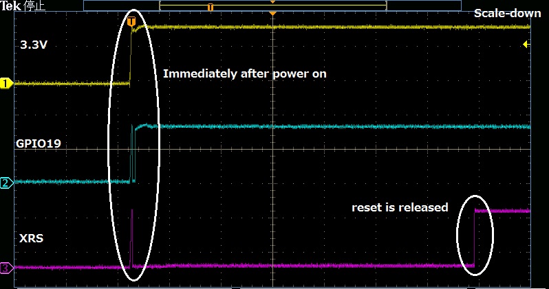

    Sorry. One more thing, there is a condition.
    Immediately after Power-On Reset period(XRS=Low), the external pull-up GPIO is Low is observed.
    The phenomenon is confirmed, the GPIO19 and GPIO34 it.
    Please refer to the waveform (scale-up, scale-down), which was observed as a representative of the GPIO19.

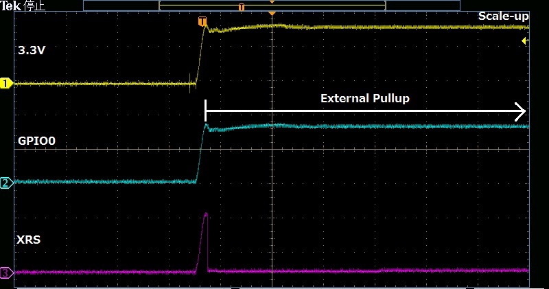

    Please refer to the waveform when the GPIO0 is pulled up externally as a comparison with GPIO19.

    additional information.
    · When pullup with a 2.2K resistor attached, it is confirmed that GPIO19, GPIO34 goes low immediately after
    turning on the power supply. (It is a phenomenon during the question)
    · When pullup with GPIO19 and GPIO34 connected externally, it did not become Low when pullup without resistance.

    Let me check the following phenomenon about factors that occur in a specific GPIO.
    What I would like to confirm is that it seems that "Low" is output as though the device is pulled up
    externally at 2.2 kΩ immediately after power is turned on.
    Because it is right after power-on, it is thought that XRS = Low and before software execution.
    To confirm the phenomenon, GPIO19 of the launch pad of F28027 is pulled up with 2.2 Ω.
    GPIO19 is not connected except pull-up.
    Refer to the attached circuit diagram.

  • Cody-san,
    Thank you for your support.
    My confirmation procedure is as follows.
    1) Disconnect the power from the LaunchPAD
    2) Connect GPIO19 to external power supply line of 2.2 kΩ for external pull-up
    3) Connect oscilloscope probe to VCC (3.3 V), GPIO19, XRS
    4) VCC (3.3 V) as a trigger and set the single trigger mode
    5) Connect the power
    Reset from S2 is not used. It is only reset by POR.
    Koichi
  • Koichi-san,
    thank you for the help with this debug. This behavior is do to power sequencing when using the internal voltage regulator. You can find several descriptions of this behavior in the DataSheet. Please see the quote below.
    NOTE: When the on-chip VREG is used, the GPIO19, GPIO34, GPIO35, GPIO36, GPIO37, and GPIO38
    pins could glitch during power up. If this is unacceptable in an application, 1.8 V could be supplied
    externally. Alternatively, adding a current-limiting resistor (for example, 470 Ω) in series with these pins
    and any external driver could be considered to limit the potential for degradation to the pin and/or external
    circuitry. There is no power-sequencing requirement when using an external 1.8-V supply. However, if the
    3.3-V transistors in the level-shifting output buffers of the I/O pins are powered before the 1.8-V
    transistors, it is possible for the output buffers to turn on, causing a glitch to occur on the pin during power
    up. To avoid this behavior, power the VDD pins before or with the VDDIO pins, ensuring that the VDD pins
    have reached 0.7 V before the VDDIO pins reach 0.7 V.
    Cody
