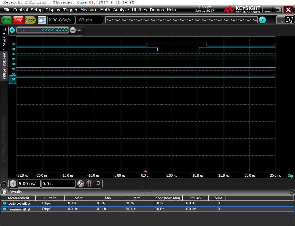

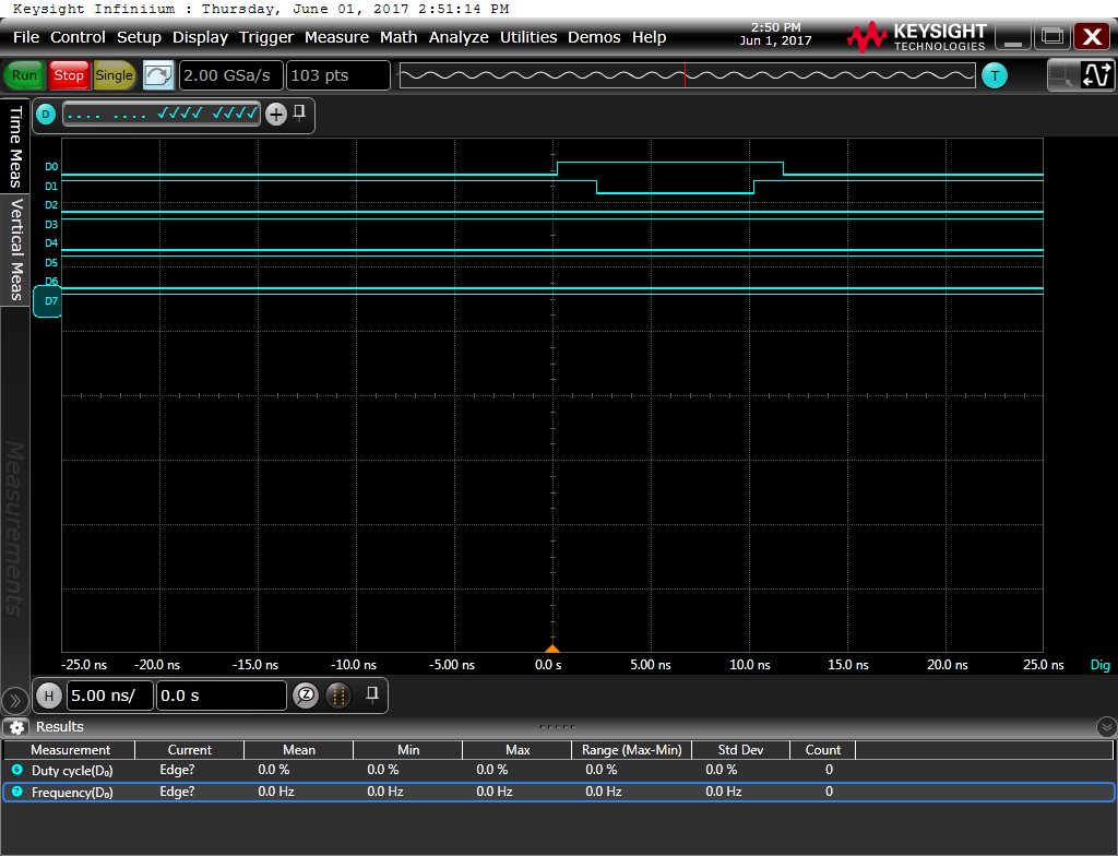

TMS320F28377S: PWM Glitch at Low Duty Cycle using Dead Band Module
Part Number: TMS320F28377S
Hi all,
I am using the 28377S to implement the modulator/average current mode loop for a 4 phase interleaved converter.  Everything is working okay except for when I drive extremely low duty cycles.  As I continue to lower the duty cycle, eventually the EPWMxA waveforms are always low and a narrow pulse on the EPWMxB waveform appears.  Eventually the pulse on EPWM1xB goes away, and then the other EPWMxB pulses go away which I would expect, but once the other pulses disappear at 0 duty cycle the pulse on EPWM1B returns.  I found this to be very strange.  If anyone can point me in the right direction as to how to fix it that would be useful.  I've attached my configuration code for the EPWM modules below.
Lance Hummel

   // Setup Deadband (assumes non-inverted gate drive signals and EPWMxA as the source for both delays)
   EPwm1Regs.DBCTL.bit.OUT_MODE = DB_FULL_ENABLE;
   EPwm1Regs.DBCTL.bit.POLSEL = DB_ACTV_HIC;
   EPwm1Regs.DBCTL.bit.IN_MODE = DBA_ALL;
   EPwm1Regs.DBRED.bit.DBRED = 0x00A;	//100MHz EPWMCLK => 10ns per count, assume 100ns dead band to start
   EPwm1Regs.DBFED.bit.DBFED = 0x00A;	//100MHz EPWMCLK => 10ns per count, assume 100ns dead band to start

  • Hi Lance,
    I am sorry for the delay in replying.
    I believe this behavior is a result of the dead-band configuration. When the duty is small enough that the dead-time is larger than the ON time, the pulses will disappear. By "a narrow pulse on the EPWMxB waveform", do you mean the xB output has a small low pulse but is close to full duty? If that is the case, then this is expected. If you mean that the xB output has a very small high pulse and is close to 0% duty, while the xA output is close to 0% duty as well, then this is a problem. Can you please clarify?
    Assuming the first scenario above, if you don't like the small low pulses on the xB output, you could change the dead-time registers when ON time is less than dead-time. OR you could also generate xB separately through the action qualifier sub-module using CMPB. You can use CMPC/D for your interrupt generation.
    I hope this helps.
    Hrishi
  • Hi Hrishi,
    To clarify I was hoping that when the duty cycle on xA went to zero that xB would go to 100%, without the small low pulse. I figured I may have to manually manage the dead time myself. I need to be able to drive the duty cycle to 100% on the xB PWM modules for proper operation of the converter. Thanks for the advice.
    Lance
  • Hrishi,
    I switched over to directly controlling the dead band using the CMPB/CMPBHR registers to control the switching waveforms, but I'm still seeing the same issue on the EPWM1xA/xB channels.  I still see these runt 10-20ns wide gate pulses with the duty cycle set to zero, and only on the EPWM1 output.  EPWM2,3,4 are constant at zero duty cycle.
    Here is my update code.  I used the debugger to verify that the duty cycle is getting set to zero and it is.  So I'm confused as to why I'm seeing anything happen on these EPWM outputs.

  • Here is a scope capture of the waveforms.  I am using a mixed signal scope and used the digital input to look at all the PWM signals simultaneously.  The analog PWM signals are basically the same, just with ripple/noise.

    What are the values of the CMPA and CMPB registers when you see these pulses? I am wondering if the values for these registers violate the duty cycle restriction when HRPWM is enabled i.e. these values cannot be < 3 or > (PRD-3).
    Also, you have now disabled the dead-band module completely, correct?

  • Hrishi,
    I am forcing the CMPA and CMPB registers to zero.  Based on my EPWM configuration I would expect EPWM1A to be low all the time, and EPWM1B to be high all the time.  I know that the HRPWM doesn't work below 3 PWMCLK counts, but I don't need the HRPWM to be working, I just need to be able to drive the duty cycle to the ideal zero.  Below is the code I'm using to update the registers via a routine run in the CLA.  The ON_OFF_READ macro is always false and forces the duty cycle to zero.  So I know all the CMPA/B and CMPA/BHR are always set to zero.  I also validated that in the debugger.  Also the dead band module is disabled.

  • When you set CMPA/CMPB to 0, you should also set CMPAHR and CMPBHR to 0. Also, HRLOAD should be set to ZRO and PRD.

  • I changed the HRLOAD to both ZRO and PRD and it did nothing to change the erroneous pulses
  • I was already doing that, with the CMPA/CMPB and the CMPA/BHR registers, and I made the change to HRLOAD and it didn't fix the issue I'm seeing on the EPWM1 outputs.
  • Could this have to do with the fact that the CMPA/B counter hits zero and the module tries to satisfy the AQCTLA/B register conditions?
  • Lance,
    This behavior is strange. We have reduced it down to a pretty straight-forward configuration and I do not expect any pulses at the output when CMPx:CMPxHR is 0.
    I think you must have already checked but please make sure that dead-band is completely disabled. Also, make sure other AQ settings are set to 'don't care'.
    If above look fine, the next thing to look at would be TZ registers. Make sure all TZCTL actions are set to 'do nothing', which is not the default.
    Hrishi
  • Hrishi,
    The dead band module is completely disabled and the other AQ registers are set to 'Do Nothing'. I also went and added code to set all of the TZCTL registers to 'Do Nothing' as well. Even after making those modifications to the code and recompiling , I still get the 10ns glitch pulses on the EPWM1A/B outputs.
    I'm not sure if it matters, but I'm using v200 of the device support library for the F28377S processor. I am using CCS7.1.0 along with the 16.9.3.LTS compiler to build my code. The code I've been testing executes from RAM, and I have no optimizations enabled. I'm okay with moving forward to a newer version of the support libraries, or even a new compiler version if there is a known issue.
    Lance
  • Lance,
    Have you seen this with multiple devices? Does the behavior improve if you disable HRPWM?
    Thanks.
    Hrishi
  • Hrishi,
    I tested this on several other processors and I saw the same behavior. If I disable HRPWM the issue goes away, but I do need to use the HRPWM. Any suggestions on how to get around this issue?
    Lance
  • Lance,
    Okay that's good. When you get to this mode where CMPA/B values are 0, in addition to making CMPAHR and CMPBHR 0 also make sure TBPRDHR is 0. If you do that, these pulses should go away even while HRPWM is enabled. You can then start using HRPWM again when the CMP values jump from 0 to 3.
    Let me know how this goes.
    Hrishi
  • Hrishi,
    The TBPRDHR register for EPWM1 was already set to 0, and even after adding code to force the register to 0 the problem still persists.
    Lance
  • The only other thing I can think of is to disable HRPE when you enter this mode and then re-enable it when you come out of this mode. BTW do you see this glitch every cycle or only the first cycle when you enter this mode (CMP = 0)?
  • Hrishi,
    It happens every EPWM cycle.  I'm already at the point where I don't have a lot of clock cycles to spare in terms of the control loop I'm running, so hopefully I can put in the ability to enable/disable the HRPE bit when appropriate and still hit the required ISR timing.
    Lance
  • To give an update. I set the HRPE register to disable the HRPWM and that fixes the glitch in question. Thanks for all the help Hrishi
    Lance
  • Hi Lance,
    Excellent! Thanks for the update!
    Hrishi
