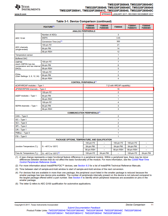

  • HI Mike,
    Can you confirm that you have the most recent documents from here:
    http://www.ti.com/product/TMS320F280049
    I see the following for the datasheet and TRM respectively:
    I'll ask someone to take a look at your specific use case too.
  • Yes I know the ePWM is type 4, but the TRM specifies type 2 HRPWM:
    Most documents seem to treat the ePWM and HRPWM as effectively separate peripherals, which may have different type. For example, table 10 in SPRU566M lists a type 4 epwm and type 2 HRPWM for the F2807x.
    In any case the distinction between type 2 and type 4 isn't made very clear in any documents I've seen. I also don't see how this distinction relates to my question.
    Mike
