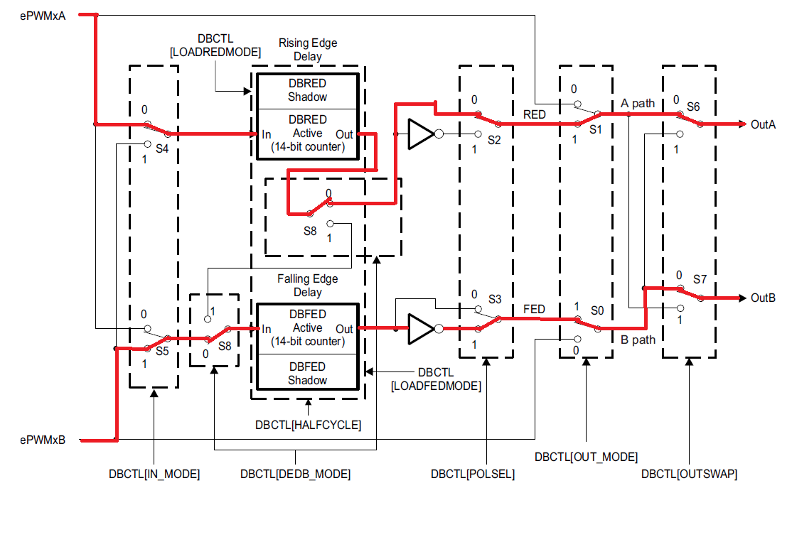

We produce the PWM signals for a buck – boost stage with a PWM unit of the C2000 F28374 using the dead band module.
While testing the PWM operation in its extreme points (start / stop, 100% / 0% dutycycle, different dead band settings etc.) I discovered a for me none plausible behavior.
The PWM unit is configured in a way, that signal A and B have the same action qualifiers on CMPA while signal B gets inverted over the dead band module. RED can be applied to Signal A, FED to singal B.
In 0% duty cycle operation Signal A is high and signal B is low, vice versa in 100% duty cycle.
Changing the duty cycle to 0% while RED is 0 and then increasing RED to e.g. 100ns forces Output A to low. This only happens when RED has been 0 before the duty cycle change. That means that changing the duty cycle to 0 with RED = 100ns and then changing RED to 0 and back to 100ns works as expected (Output A stays high).
Same thing happens on Output B in 100% duty cycle operation when changing FED.
Of course using dead times for 100 or 0% duty cycle does not make sense and probably we never see this scenario as we have minimum allowed dead times so no one could set FED / RED to 0 in normal operation. Anyway my claim is understanding the configuration and the resulting behavior of the PWM unit to 100% in all theoretical possible operating conditions.
Are there any explanations for this behavior?
Below you can find our configuration routines:

EPwm1Regs.DBCTL.bit.IN_MODE = 0x2; // EPWMxA is the source for rising-edge delay, EPWMxB for falling-edge delay. (S4 = 0, S5 = 1)
EPwm1Regs.DBCTL.bit.DEDB_MODE = 0x0; // S8 = 0
EPwm1Regs.DBCTL.bit.POLSEL = 0x2; // invert ePWMxB signal coming out of falling edge delay block (S2 = 0, S3 = 1)
EPwm1Regs.DBCTL.bit.OUT_MODE = 0x3; // enable Dead-band module for EPWMxA and EPWMxB signals (S0 and S1 = 1)
EPwm1Regs.DBCTL.bit.OUTSWAP = 0x0; // S6 and S7 = 0
EPwm1Regs.DBFED.bit.DBFED = PWM_DEADTIME_IN_TICKS; // FED = 50 TBCLKs initially
EPwm1Regs.DBRED.bit.DBRED = PWM_DEADTIME_IN_TICKS; // RED = 50 TBCLKs initially

Hi Baskaran,
I already went through the suggested post and this is not the same issue I have seen. For our application it is not critical when the FED/RED changes take impact on the output signals.
What I have seen is that changing RED from 0 to a higher value in 0% duty cycle operation forces output A from constantly high to constantly low. Same thing with FED and output B in 100% duty cycle operation.
In my opinion there shouldn't be any edges or changes of the output signals in 0% or 100% duty cycle operation.
As I mentioned this behavior is only seen if RED/FED had been 0 when entering 0%/100% duty cycle operation. If RED/FED had been for example 100ns when entering 0%/100% duty cycle operation and then get set to 0 and back to other values everything works like expected (output signals stay constant).
Jens
When reading this keep in mind that I do not know the internal structure of the dead band module and my recommendations are based only on practical experiences and from discussions on E2E forum. Also the operation of dead band module differs on the silicon used and I've got most experiences with 28069
Dead time module is not really intended for on line reconfiguration. As the internal compare registers are not shadowed so you might observe strange phenomena when changing RED of FED values or othre DB configuration registers. This phenomena might appear sporadic or even random in nature but the underlying cause is the timing of the write to the DB module with respect to the internal counters.
My advice for the projects where you need to vary dead time is to disable dead time module and use AQ module with comparator A and comparator B to generate dead time (look at the example on figure 14-29 on page 1585 in SPRUHM8F)
Hi Mitja,
thanks for your feedback.
We moved from the 28069 to 28374S and one thing to notice regarding online reconfiguration of the dead band module is, that the newer devices with generation 4 PWM unit have an optional shadow registers for RED and FED writes. Therefore I assume that I'm allowed to change RED/FED values online, otherwise those shadow registers do not make sense to me.
After your answer I rechecked my configuration and saw that I did not use the shadow registers for FED and RED. Unfortunately after changing the configuration to use them, I can see the same behavior as before.
Can anyone of TI confirm that changing RED and FED registers online is allowed?
Jens
Thanks for the update. It seems that with each new generation you really have to scan through all the documentation again, to catch small changes.
On thing I would try is to change RED and FED from 1 to higher value and back, instead of going to and from 0. This might be similar issue that old ePWM modules had when setting CMPA to 0 or to PRD as the could not generate 0% and 100% duty on PWM signal.

Hi Jens,
There should not be a problem with online changing of the deadband registers. Is this still an ongoing issue that you would like us to try to reproduce?
Kris
Hi Kris,
it would be great if you could try to reproduce this issue as I want to make sure that I didn't configure anything wrong.
Jens
