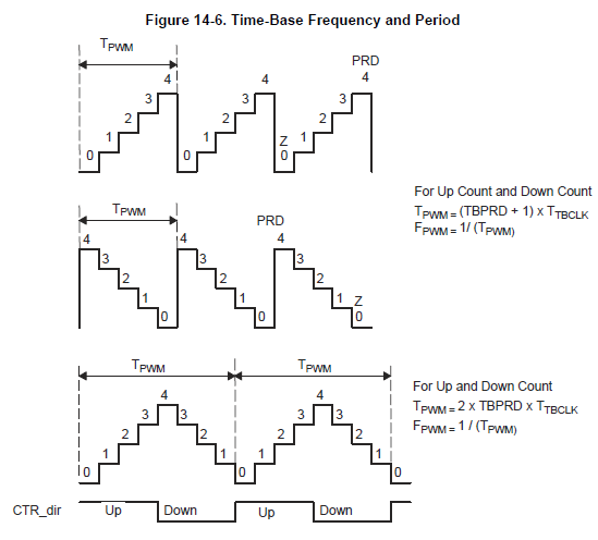

HELLO
1.i am working with TMS320F28379D.kit for my application
to generate the PWM with 20KHz.
as per my understanding this device pulse width values for a SYSCLKOUT = 100 MHz.
according to this value i should get the value of TBPRD = 5000(SYSCLKOUT/PWM freq)
but i couldn't  way it not getting?

  • TBPRD should be 2500 for up-down count mode.

  • Hi Kudithi,
    The TBCTL.CTRMODE is set as up-down. Hence the TBPRD = fTBCLK/(2 * fPWM).
    In this device,
    max SYSCLKOUT = 200 MHz,
    max EPWMCLK = 100MHz,
    TBCLK = EPWMCLK/(HSPCLKDIV * CLKDIV)

    Exactly! For TBPRD = 2500; HSPCLKDIV & CLKDIV should be /1.

  • Hi Nageswara,
    Assuming the sysclk is 100 MHz. You need to configure all the following:
    EPwm1Regs.TBCTL.bit.HSPCLKDIV = 0;  // means  /1
    EPwm1Regs.TBCTL.bit.CLKDIV = 0;          // means /1
    ClkCfgRegs.PERCLKDIVSEL.bit.EPWMCLKDIV=0;  // means /1 of pllsysclk
    With the above setting:
    sysclk = 100 MHz
    epwmclk = sysclk/epwmclkdiv  = 100 MHz
    tbclk = epwmclk/(hspclkdiv*clkdiv) = 100 MHz
    tbprd = 100MHz/(2 * 20KHz) = 2500
    Also Case 1 & Case 3 are same as TB_DIV1 should be 0.
    For Case 4 what are the hspclkdiv & clkdiv values ?
    Vasudha

    if i used like this i got 20KHz for TBPRD=2500;
    Case:3
    EPwm1Regs.TBCTL.bit.HSPCLKDIV = TB_DIV1;
    EPwm1Regs.TBCTL.bit.CLKDIV = TB_DIV1;
    but
    how i can get 20KHz for TBPRD=5000?
  • For up-down counter mode, TBPRD = 2500 for 20KHz.
    You can change the ctr mode to up or down, then TBPRD = 4999 will give 20KHz.
  • way it not possible for CTRMODE?
    because it is 200MHz processor
