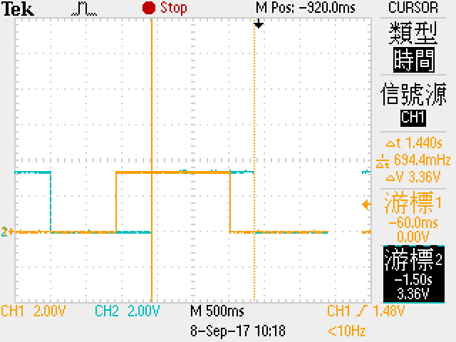

Trying C:\ti\controlSUITE\device_support\F2837xD\v210\F2837xD_examples_Dual\ipc_gpio_toggle example,
when I use attach files (ipc_gpio_toggle_cpu01_bsp001.c & ipc_gpio_toggle_cpu02_bsp001.c) and run in RAM,
both toggle signals of CPU1 & CPU2 are synchronizing.
But CPU2 toggle signal was faster than CPU1 when run in flash.
Any explanation for the difference access speed between CPU1 & CPU2 flash?
thanks,
best regards,
Simen
CPU2 toggle timing in flash
CPU1 toggle timing in flash

  • Simen,
    Assuming that you use same waitstates on both CPUs and that there are no interrupts, the difference can be because of the code alignment in the memory - which can cause more or less fetches.
    Try putting your toggle code in a separate function and map it to the same address on both cores.
    Thanks and regards,
    Vamsi
  • Hi Vamsi,
    Your answer is right.
    They can synchronize when I map "loop function " to the same address on both cores.
    thanks,
    best regards,
    Simen
  • Simen,
    Glad that it worked. Flash fetches are 128-bit wide and the location of the code in this 128-bit aligned memory will cause differences in number of fetches when prefetch is enabled. When you map them to the same address, fetches will be similar. For better performance, always map your functions (if possible) at the start of a 128-bit aligned memory.
    I am closing this thread.
    Thanks and regards,
    Vamsi
