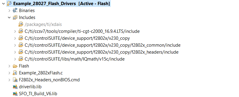

    My mistake, I am using ControlSuite, not C2000Ware. I don't have such file directory. I've been trying to setup my project like the following below:
    I have made appropriate changes to my project by adding the SFO_TI_BUILD_V6 and including the necessary files in the code:
    #include "DSP28x_Project.h"
    #include "f2802x_common/include/sfo_v6.h"
    Here is what my project looks like:
    If I can't figure it out, I suppose I can try to resort to copying this example and going from there, but I'd like to figure out how to make my current project correct.
    Jeff
  • Hi Jeff,
    Using ControlSUITE is fine and it looks like the SFO header file's path is being included based on your screenshot.
    Can you check you have this code in your project's C file?
    volatile struct EPWM_REGS *ePWM[PWM_CH] =
    { &EPwm1Regs, &EPwm1Regs, &EPwm2Regs, &EPwm3Regs, &EPwm4Regs};
    The SFO library expects an array with pointers to the register structs as it uses bit-field programming as opposed to Driverlib programming that you have in your project.
    Elizabeth
  • Elizabeth,
    Yes, that was it. I eventually figured that out after adding in all the code from the example until my project compiled. Thanks for your support!
