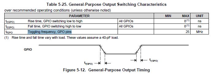

I want to drive led matrix display with HUB75 interface. I extract data from computer thru USB and send them to about 20 HUB75 interfaces. I want to know what is the max frequency supported by this MCU in GPIO pins?
    The datasheet section 5.7.6.1 mentions this:
