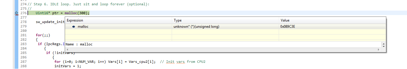

I'm trying to run a simple code:
 Uint16* ptr = malloc(300);

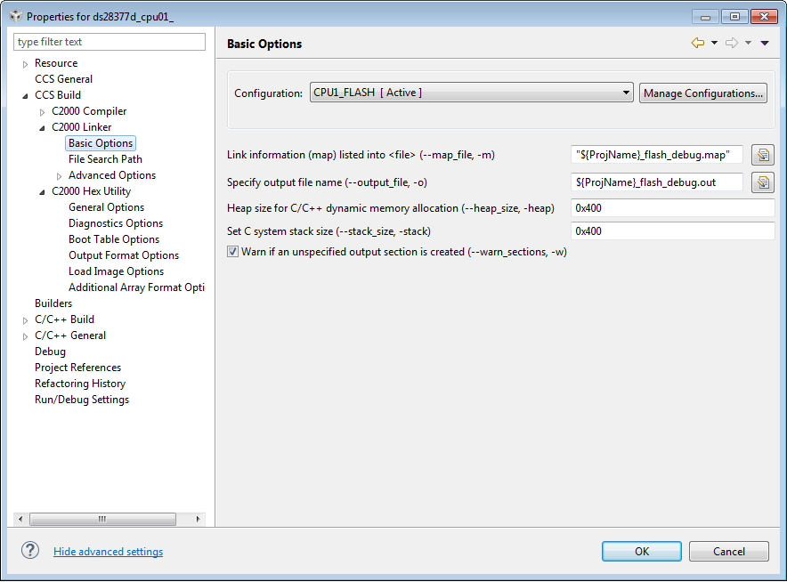

my project properties:
in cmd sysmem is written:
   .esysmem             : > RAMD0       PAGE = 1
If i run my code in CPU1 works OK. But if i try to run it in CPU2 it, after calling malloc() debugger jumps to:
// Connected to ITRAP of CPU (non-maskable):
__interrupt void ILLEGAL_ISR(void) // Illegal operation TRAP
EINT;
// Insert ISR Code here.......
// Next two lines for debug only to halt the processor here
// Remove after inserting ISR Code
__asm (" ESTOP0");
//for(;;);
Project runs in FLASH. Project properties "-heap" are equal in CPU1 and CPU2 projects, us well us .esysmem section in cmd file
What could the problem be?
