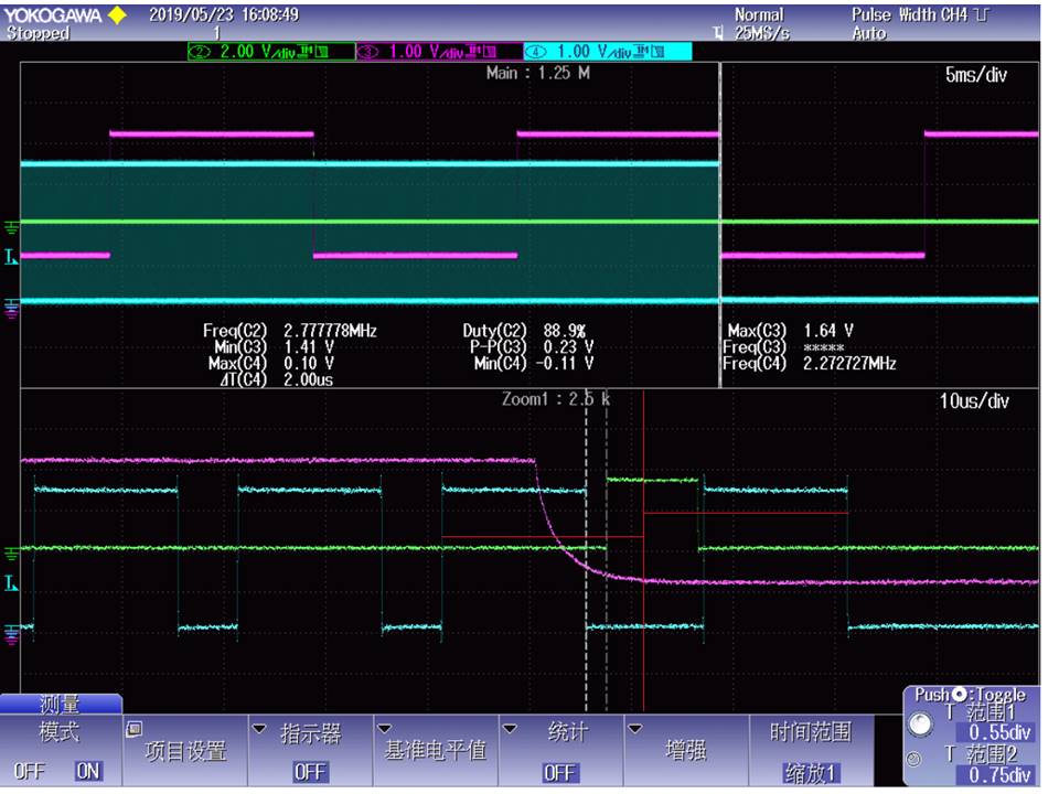

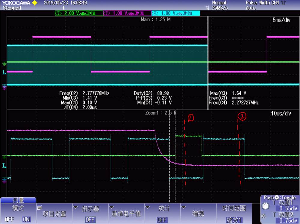

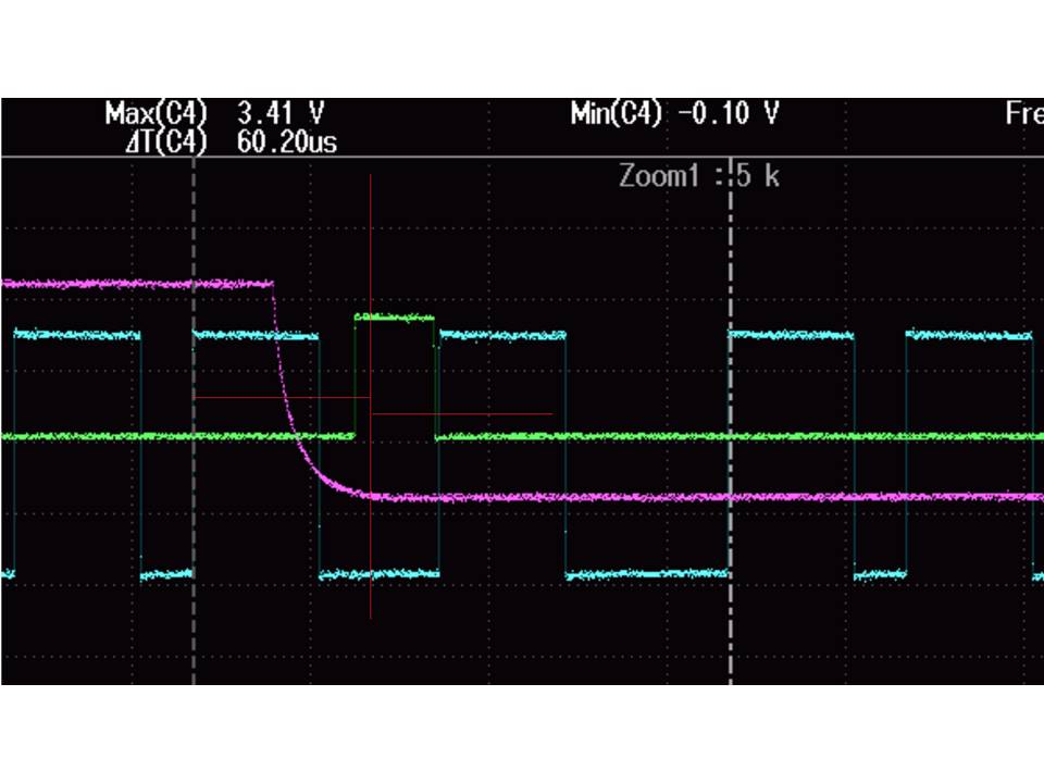

    In simple words, they are running two ISR without nesting, the ECAP ISR and the ADC ISR. they indicates the timing of these two ISR by toggling GPIOs. high voltage level indicates the ISR is funning.
    In lower part of below graph, green line indicates ECAP ISR and blue line indicates ADC ISR. You can see that the ADC ISR should start at "one" but delayed and the next ADC ISR should start at "two". In the circumstance, the delayed ADC ISR is still running, will this cause an interrupt overflow? For ADC ISR is not triggered any more.
    In another situation.
    This case also gets a delay in ADC ISR but following ADC ISR are triggered normally. Why this situation didn't get an interrupt overflow? Are there anything to do with the running of last ADC ISR and newly raise ADC interrupt?

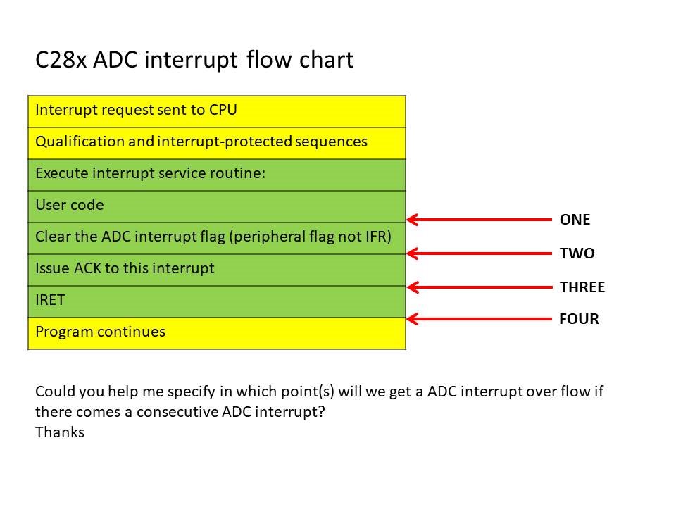

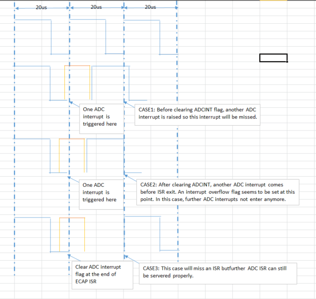

    I still have some questions on details regarding your comment: ADC interrupt overflow will occur whenever another ADC interrupt occurs while there is an active ADC interrupt that is not yet cleared.
    We have two situation who both have another ADC interrupt occurs when there is still ADC ISR running. Please check my attached PPT for details on this!
    Thanks!
