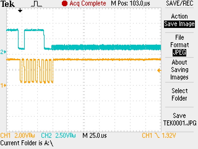

Because the waveform now looks like this
DSP is only able to send the first byte, 0x7C, the rest 2 bytes are missing and no stop condition is generated.

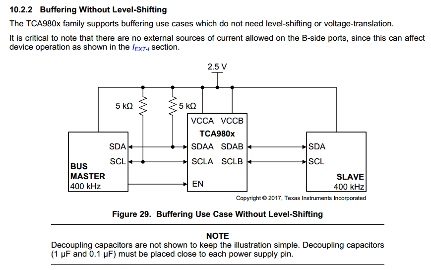

The buffer chip I use is TCA9803 from TI, and the circuit schematic is here.
I use 3.3V here. EN is directly connected to 3.3V.
I guess it is a hardware problem. Can anyone help me with this?
  • Hi Xiaoming,
    What pull-up resistance are you using? Before adding the I2C buffer did you try adjusting the pull-up resistance at all? Reducing the pull-up resistor value may help, or there could be too much capacitance on the bus, more than 400pF, which you may or may not be able to help.
    In the 2nd waveform, after adding the I2C buffer, it looks like the bus gets corrupted when the slave device is supposed to ACK. What interface are you probing on, i.e. master to I2C buffer or I2C buffer to slave? Would be good to check both of these interfaces.
    It might be helpful to post your question on the respective TCA980x forum, as the experts will be more familiar with the device.

    For the first graph, I connect LCD directly to GPIOs without pull up resistor. Is it the correct configuration or do I need to add pull up resistors like this?
    For the second graph, I probe on buffer to slave. My guessing is that the response from slave is not able to transmit back to DSP(master).
    Xiaoming
    That's what it looked like to me initially. Though it does seem odd that the 9th clock pulse from the master (for ACK/NACK) is not seen. Maybe the slave is holding SDA low to signal an ACK and waiting for the clock pulse from the master, but it never sees it. The SDA signal is very noisy, so I'm not fully sure.
    Could you probe the master/buffer interface and provide a screenshot here? Also checking the I2C registers on the master side after this failed communication may say something (I2CSTR and I2CMDR registers at least).

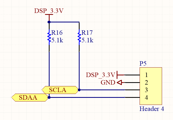

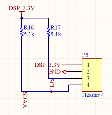

    I find the hardware reason of rise time issue. Now I remove the capacitors on the I2C bus wire and now the rise time looks good.
    I also tried disable internal pull up and added 2 3.6kohm external pull up resistors(I did not find a 5.1kohm). The rise time is even better.
