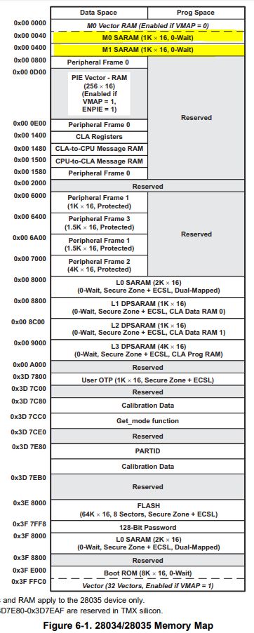

    Thank you very much for your reply. I carefully read the case you provided me in above comment (https://e2e.ti.com/support/microcontrollers/c2000/f/171/t/821593). According to this, it is required to modify linker command file in order to download bootloader code into RAM unsecure for unlocking the device, and after this, to perform disered action such as FW update with the pretend Flash. I am currently using microcontroller TMS320F28035, and I have found the following information regarding memory map for this specific target:
    Based on this chart, M0 or M1 are the only unsecured memory blocks available, since there is no L4-L8 memory spaces avaialble for this purpose. Is my understanding correct?

  • Yes, the procedure is as follows:
    1. Modify linker command file in order to download bootloader code into unsecure RAM for unlocking the device
    2. Unlock the device
    3. Download the flash API and application code into available RAM
    4. Perform desired action such as FW update.
    Yes, M0 and M1 are the only two unsecure RAM blocks. Make sure you do not corrupt some other section in these blocks such as stack etc.
