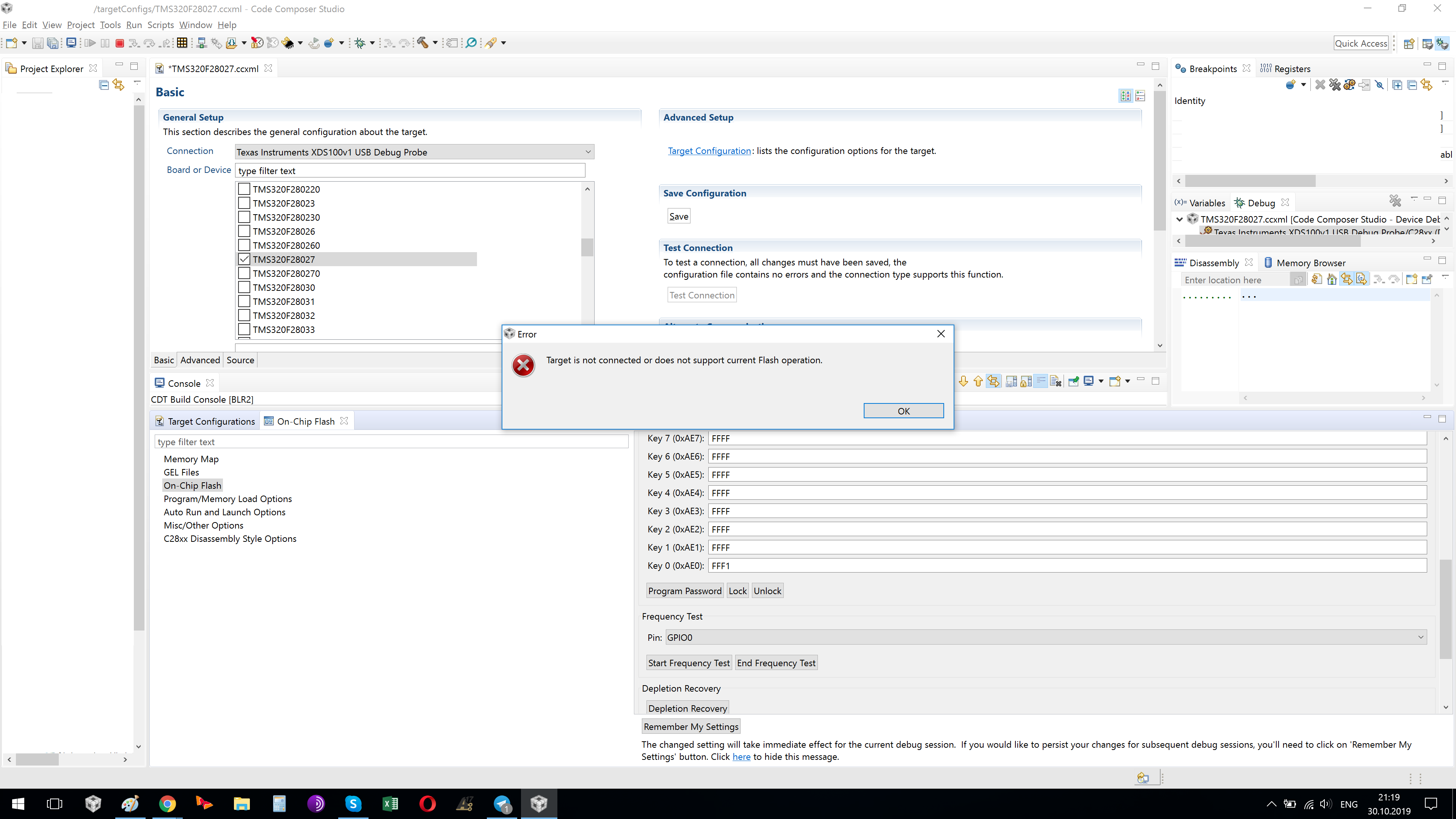

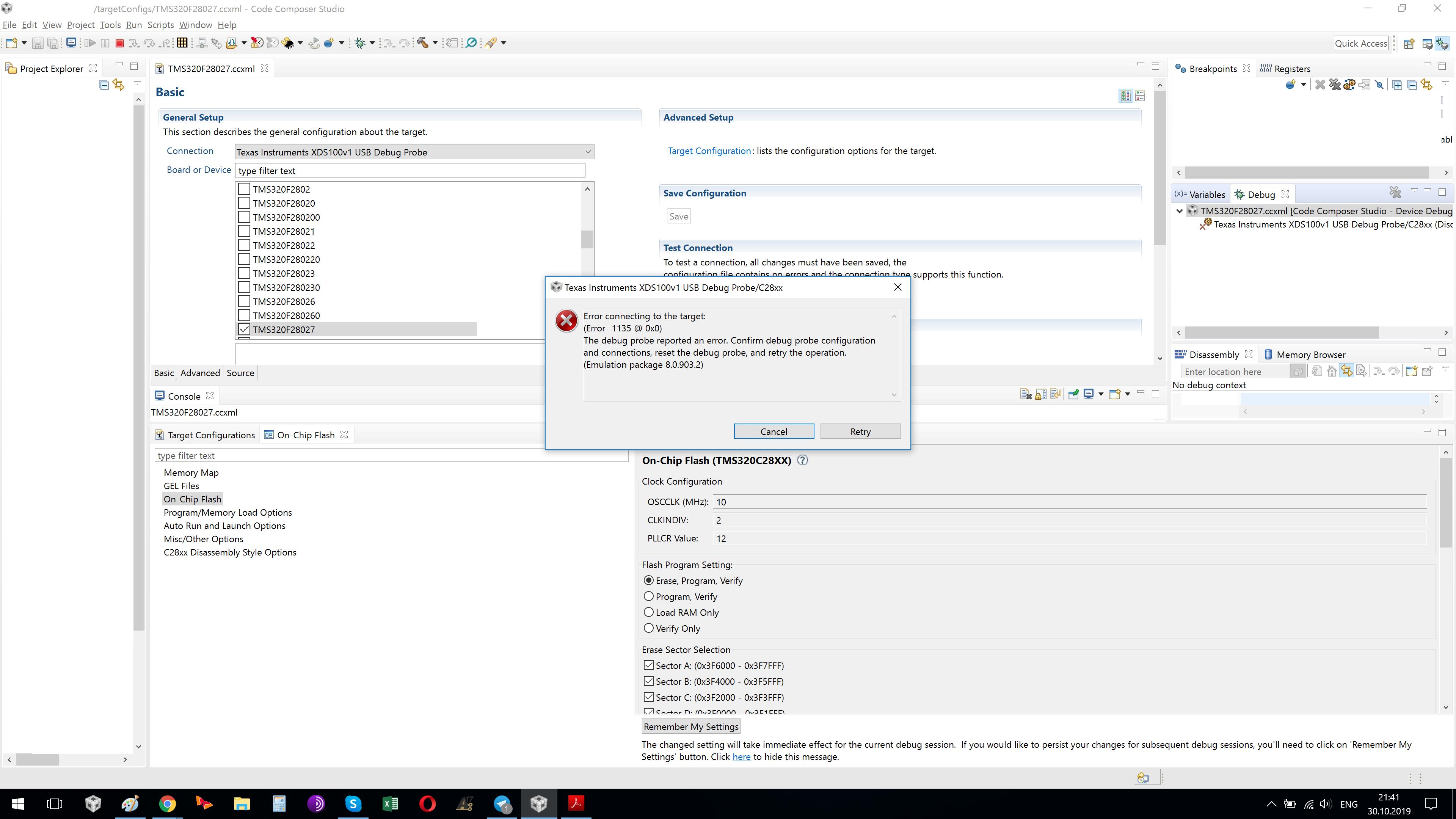

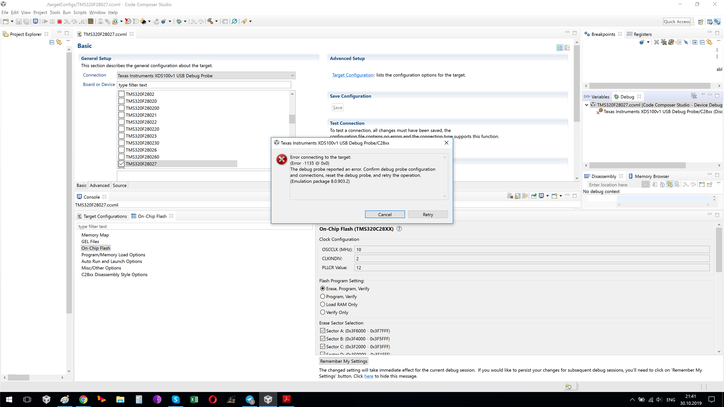

5. After that I can't connect to the mcu irrespectible of values in CSM keys.. And get "Error connecting to the target: (Error -1135 @ 0x0)" error...
This happens twice on two mcu's. Before setting CSM password everything was ok with connecting and debugging.
No reloading or resetting helps..

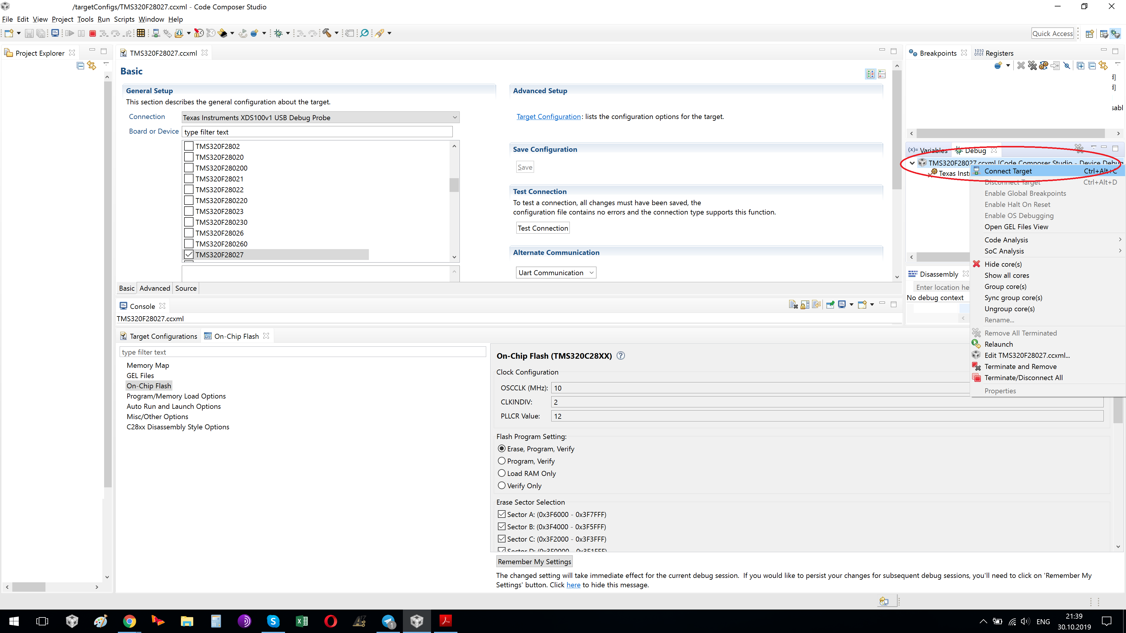

I'm using CCS Version: 8.3.0.00009, XDS100v1.
MCU works ok.

    Is this a custom board or are you using a F2802x evaluation board made by TI?
    What do you have the boot mode selection pins set to? Maybe try a different boot mode by configuring the GPIOs differently when running into the issue where you cannot connect:
    I believe what you explained regarding the JTAG reset behavior before the CSM issue is expected and normal behavior.
    Kevin
  • Hi, Kevin
    I've tried next setups:
    1. custom mcu board + custom JTAG programmer + Boot to flash mode / Parallel IO mode.
    2. commercial mcu board + custom JTAG programmer + Boot to flash mode.
    3. TMS320C2000 Experimerter Kit with 28027 controlCard.
    In all 3 cases results are the same.
    I've tried on another laptop, also I tried with another USB cable... The result is the same - after programming CSM i can't connect to the mcu..
    Here is the message from console at very first try to enter debug after burning CSM password
    C28xx: GEL Output:
    Device Calibration not complete, check if device is unlocked and recalibrate.C28xx: Flash Programmer: Warning: The configured device (TMS320F28027), does not match the detected device (). Flash Programming operations could be affected. Please consider modifying your target configuration file.
    C28xx: GEL Output:
    Device Calibration not complete, check if device is unlocked and recalibrate.C28xx: File Loader: Verification failed: Values at address 0x3F6CF3@Program do not match Please verify target memory and memory map.
    C28xx: GEL: File: C:\Users.........\xxx.out: a data verification error occurred, file load failed.
    C28xx: Verification-Only step completed.

  • Hi Konstantin,
    Have you already tried unlocking the device with the passwords you set using the On-chip Flash tool within CCS?
    Launch your target config file --> go to 'Tools' at the top of the debug mode --> select 'On Chip Flash' --> in the on-chip flash window scroll down to the "Code Security Password" section --> Enter in your passwords and click unlock
    Let me know how that works.
    Kevin
  • Hi Kevin,
    Before unlocking device I have to establish a connection to it. (on chip flash window can be populated only after debug session has been started)
    But I can't start a debug session due to error connection to the target...
    As I understand correctly - if I flash mcu it should be no matter if it is locked or not. The Flash programmer just erases previous password and uses new one, right?
  • Konstantin,
    You can connect to the target device and use the On-chip flash tool without starting an active debug session and loading code. Please follow the steps I mentioned above after launching the proper target config file and connecting to the device, i.e. right click C28x core and click connect to target.
    You cannot erase the flash if the device is locked. You must unlock it first with the programmed passwords.
    Kevin

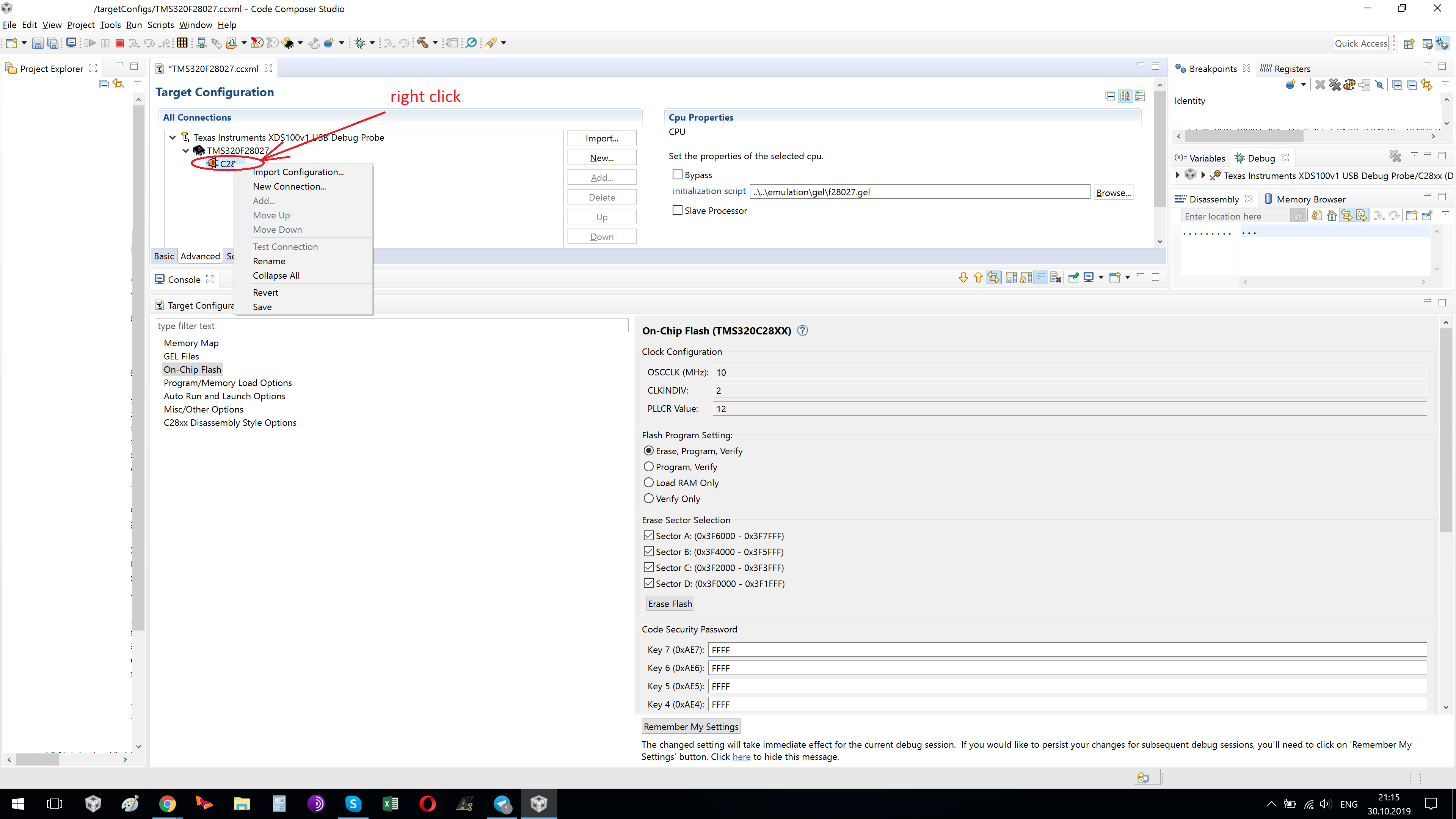

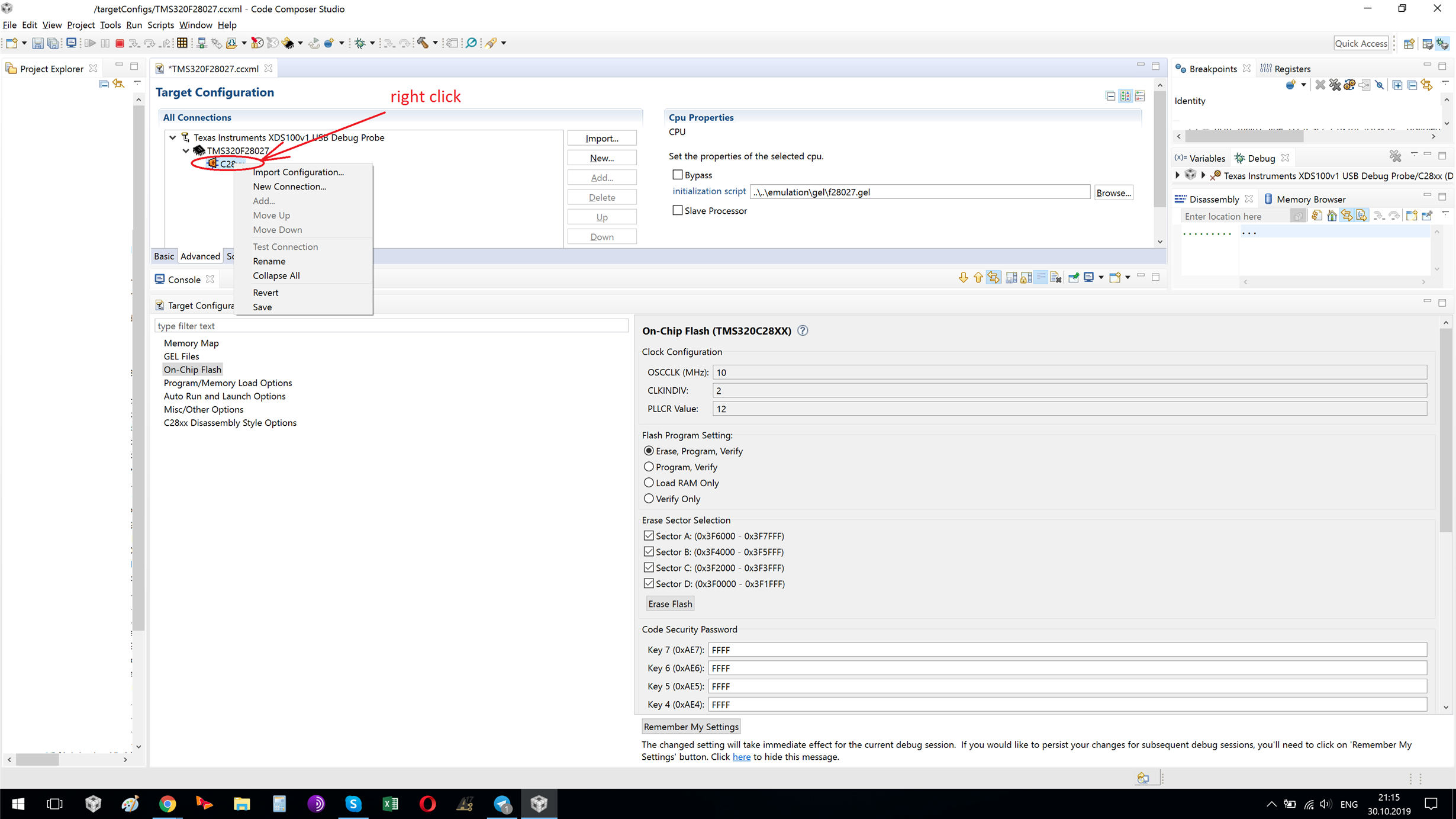

  • Kevin,
    I can't find "connect to target"
    here is whas i see in ccs
  • The only place i found connect to the target resalts the same as i've told you earlier
  • Konstantin,
    OK, I see. You're 2nd post is what I was meaning when trying to connect to the device.
    Can you try testing the connection of your target config and see if that works? Are you sure your debugger is a XDS100 v1 and not v2? Most of our evaluation boards use a v2 (though I know you said this is a custom board).
    Kevin
  • Kevin,
    Looks like i managed to connect to the mcu.
    The issue was with boot option. If either or both switches of SW1 on ControlCARD turn off(any exept BootMode=GetMode) it connects to mcu and unlocks.
    It looks strange, coz on my custom board i've tried all combinations with boot mode.
    Also it's strange that there is not possible to connect to the locked target when using GetMode.
    Below is what i get in console window. Is it ok that configured device does not match detected device? Also there is no difference wether i set up XDS100V1 or V2 in config.
    C28xx: GEL Output:
    C28xx: GEL Output:
    Device Calibration not complete, check if device is unlocked and recalibrate.C28xx: GEL Output:
  • Hi Konstantin,
    GetMode is configured to Boot from Flash by default, so that is likely why you cannot connect.
    The warning about the configured device appears when using the TMDSCNCD28027 and a target configuration that matches the F28027 device? This along with not being in getMode? I can't think of why that would happen if so, TMS320F28027 set in the target config matches the device correctly.
    Kevin
