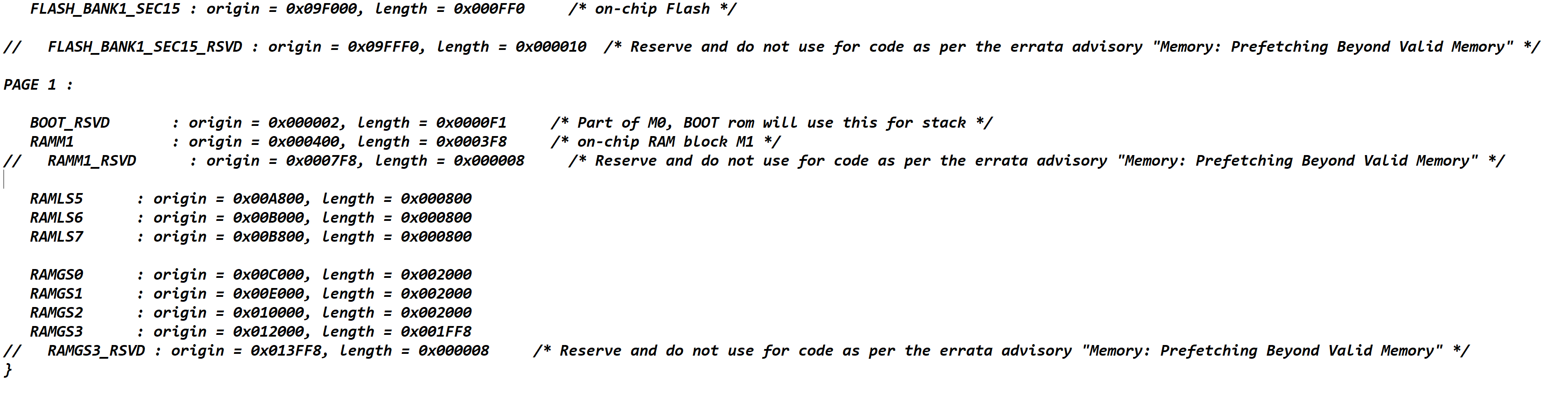

    It seems our sample linker cmd file does not try to deal with this....
    Would you please help check this again?
    If not, would you please help discuss with software/compiler team to avoid this erratum because our customers have concerns.
    Another question, if this erratum is accidentally violated, what will happen? What will the user see on CCS and in standalone?
    Please see this snapshot from the generic linker cmd file (28004x_generic_flash_lnk.cmd) we have in C2000Ware. You can see that it has mention of this Errata and reserved the locations accordingly.

  • Dear Vivek,
    I just realized that the file I checked was the same, but was in older version C2000Ware_2_00_00_03.
    Yes, I downloaded the latest version C2000Ware_2_01_00_00 and checked the file has been updated just as you said.
    C:\TI\c2000\C2000Ware_2_01_00_00\device_support\f28004x\common\cmd\28004x_generic_flash_lnk.cmd
    That is, the .cmd has been updated in the latest version.
    It's good to have that.
    Please also update the behaviors if the user violates the erratum.

  • Hi Wayne,
    As mentioned in the document, in such case it may ITRAP. Incase of flash it may get ECC error.
    Also compiler does not take care of this.
