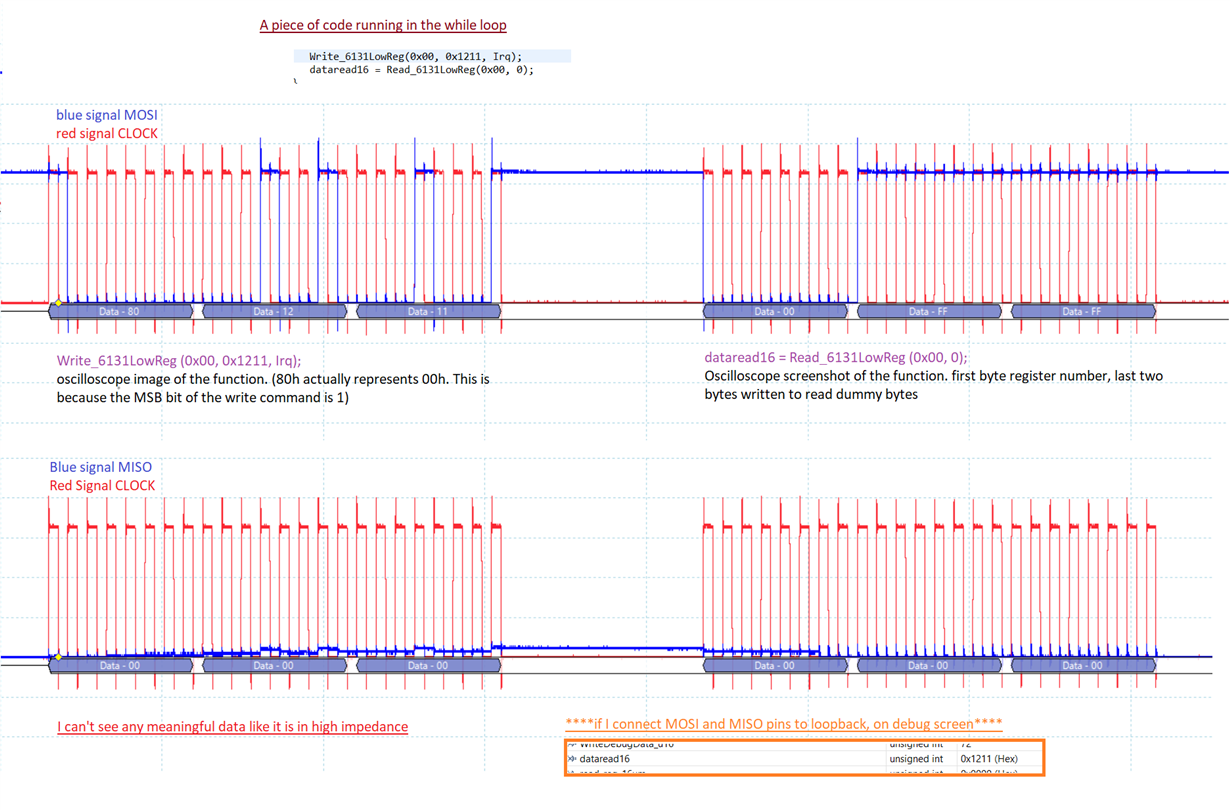

hi, in my project I set the processor as master and I use a hi-6138 module as a slave.
To set the slave device, I need to write and read some values ​​in the registers of the sensor. I can see the data I sent with the help of an oscilloscope, but I cannot read any meaningful data (reading 0x0000) because this is why I need to read while initializing the device. so if I can't do the reading function correctly, I can't initialize the sensor.
here are my spi settings

I can't find where I made a mistake. I had to add some delay (to complete the communication) during the communication. but still it didn't work. I use Gpio57 as the CE pin and set it as gpio (not as spiaste). and the enable pin stays low throughout the clock, there is no error in the scope view.
HELP PLEASE...

  • actually, I split the data for "SPI_writeDataNonBlocking ()" written in "unsigned char Write_6131LowReg" function, like this:
            bufferTX [0] = (data); // upper data byte 4800
            bufferTX [1] = data << 8; // lower data byte
    First I loaded the 16-bit data directly and made the transfer of the high byte, then I shifted the low byte and made it transferred. I can see it by loopback or in the scope view.
    then, for the "SPI_writeDataNonBlocking ()" function is written in the "unsigned short Read_6131LowReg" function, I did not scroll because the typed data are meaningless dummy data.
    you mean, will this data stay in the shift register and cause problems?
    thanks a lot
  • Merve,
    If I understand you right, it looks like C2000.SPI (Master) is transmitting what you would expect to transfer to slave. So, the problem shouldn't be with C2000 SPI peripheral, I would then check hi-6138 datasheet to see whether your command structure is matching with what slave is expecting.
    Manoj
