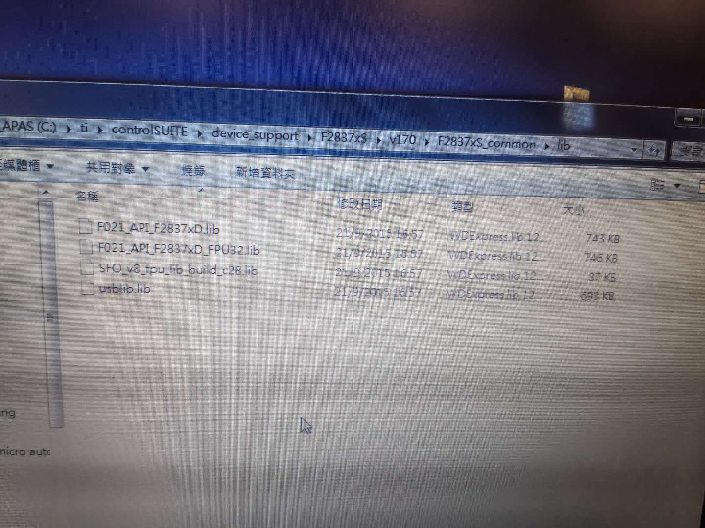

    Hi, Sidharth,
    i modify based on your suggestion:
    originally, i use ..\F2837xS\v170 to compile and there is no file called F021_API_F2837xS_FPU32.lib. please refer to below:

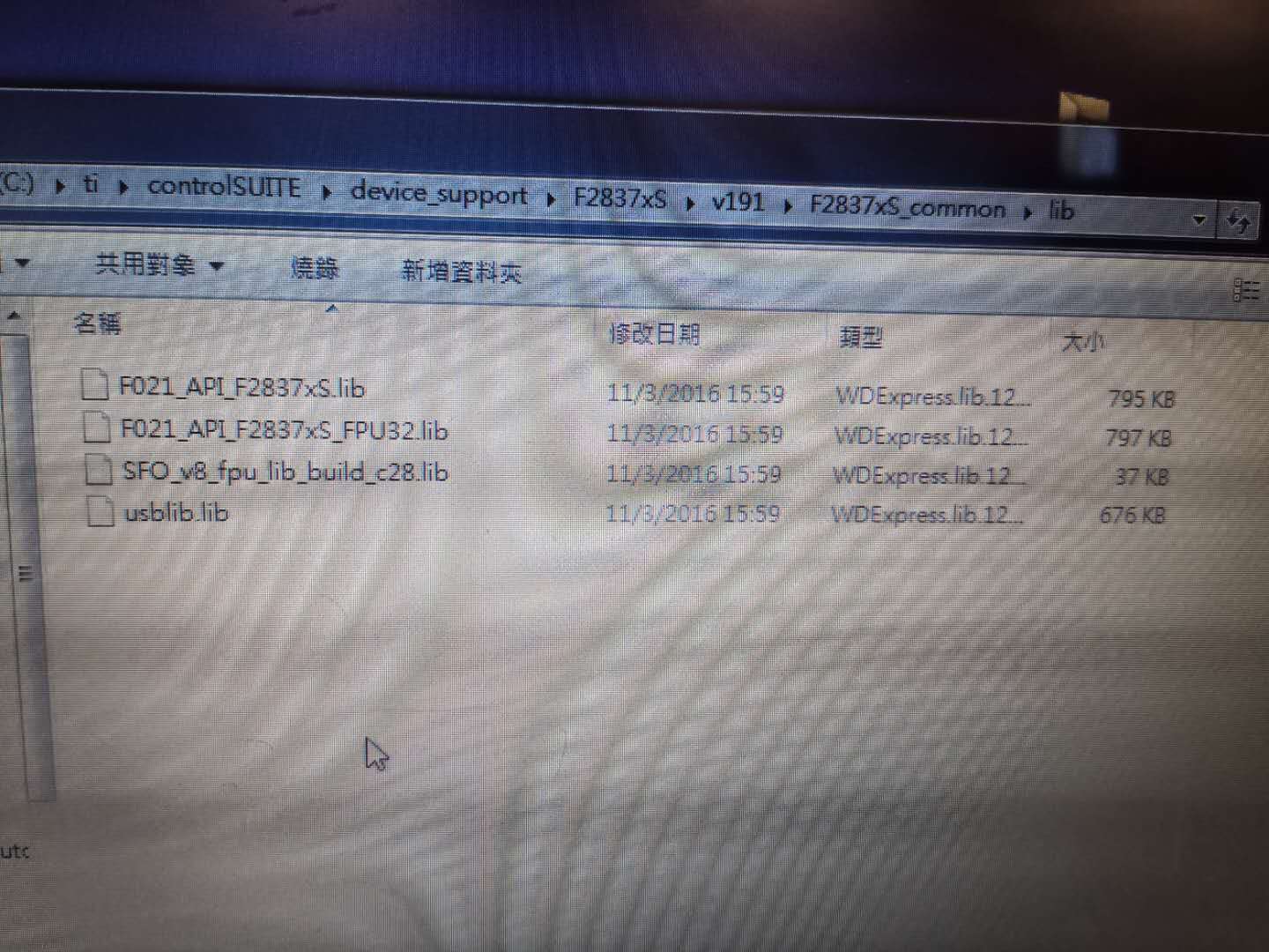

    then upgrade to use  ..\F2837xS\v191 and the file F021_API_F2837xS_FPU32.lib is in there. please refer to below:

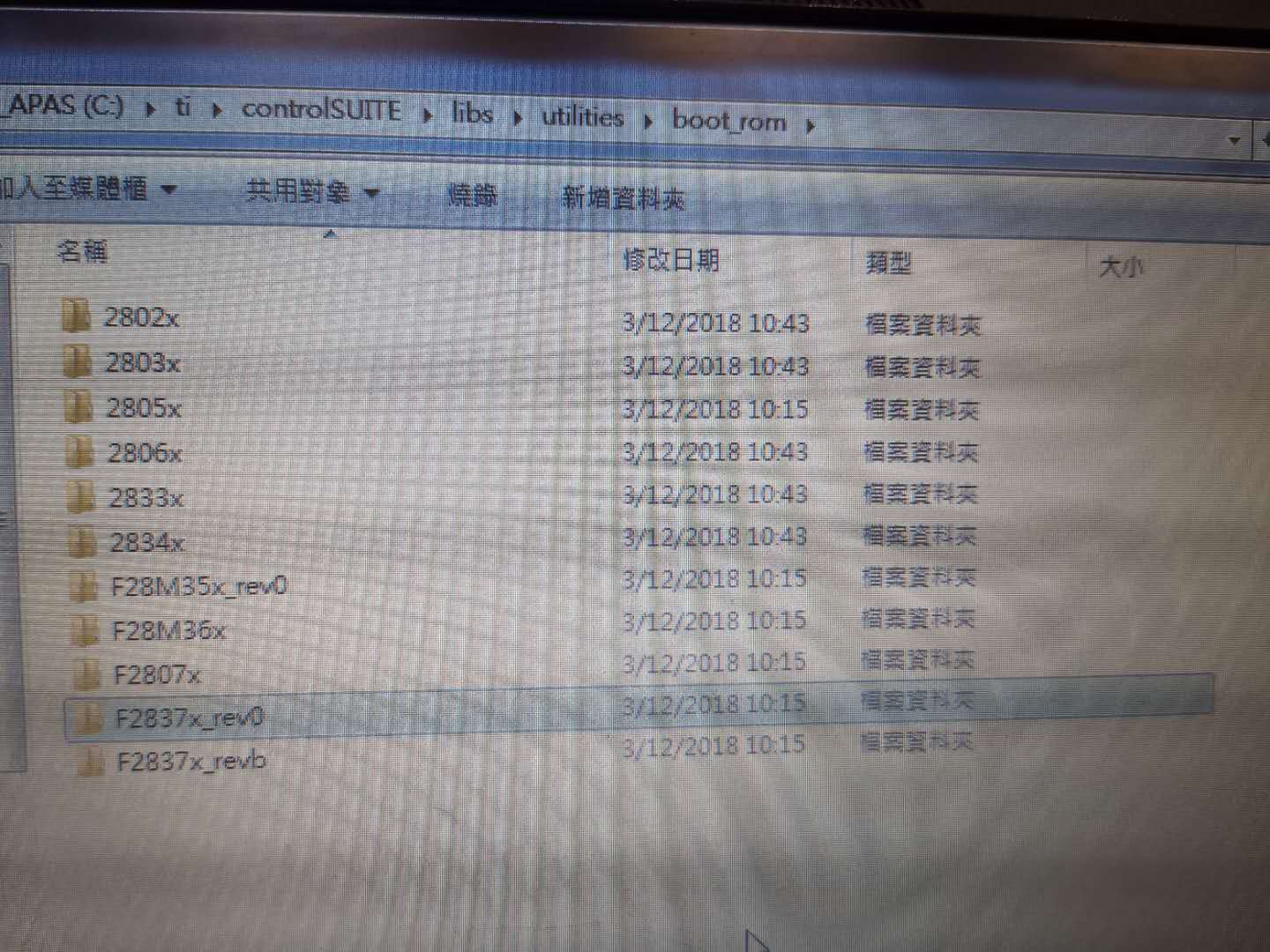

    And, you said that  i should update the Boot ROM (c1bootROM_BootROMSymbols_fpu32.lib) point to F2837xS, but i checked that there seems no Boot ROM point to F2837xS in my current version of ControlSUITE. please refer to below:
    actually two files in two folders(F2837x_rev0 and F2837x_revb) listed in above figure are tested with NO success.
