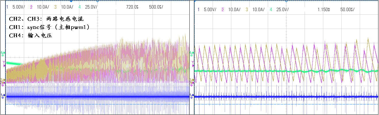

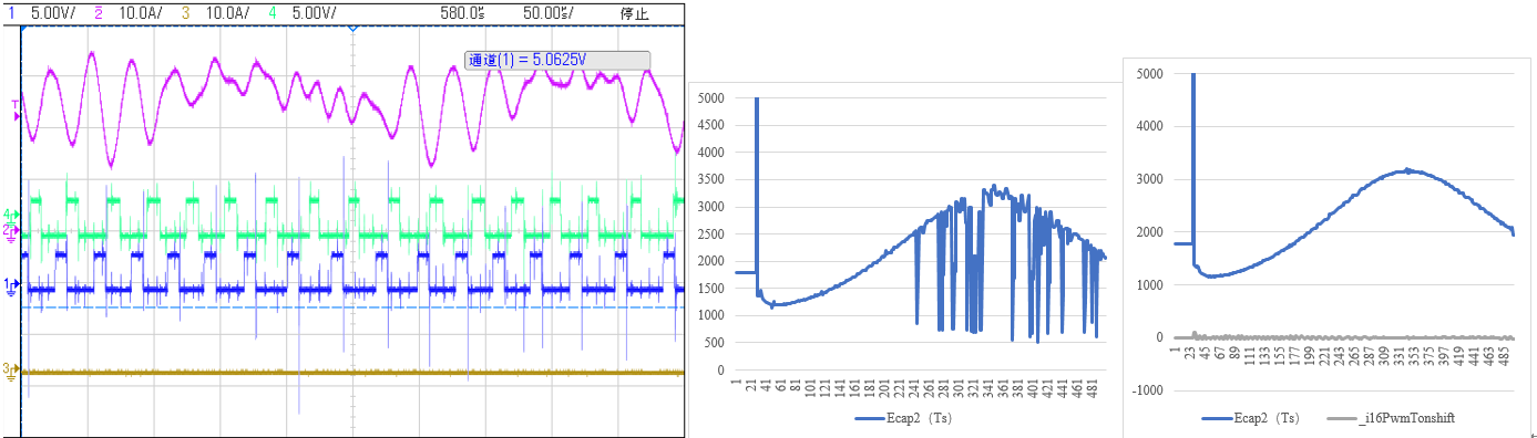

Customer reported an issue, that using eCAP to capture the period of an EPWM, the capture results showed lots of noise effect, but they were using the Output X-BAR to select the EXTSYNCOUT as the input signal for eCAP. Basically, it should be an internal signal capture, and it should not be affected by the external noise, but it did not help either.
The previous results by capturing the EPWM output as below, which showed the capture results was affected by the noise. The right one should be the expected result.

  • Hi Aki,
    Can you label the plots you attached? I'm not sure what I'm looking at.
  • Frank,
    For 1st image, CH1/CH4 are the EPWM1A/1B, CH2 need to confirm.
    For 2nd image, it refers to the captured results for the period of EPWM1.
    For 3rd image, it refers to the expected results for the period, or during light load(less noise).

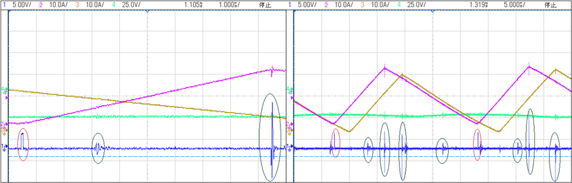

    Ok. Can they bring out EXTSYNCOUT on a GPIO so we can see what it looks like for the problem case?
  • Frank,
    Yes, they also brought out EXTSYNCOUT  to GPIO11 with Output X-BAR 7.
    CH1/2 are the inductor currents,  CH4 is the EXTSYNCOUT at GPIO11.
    As shown, the red highlighted ones should be the correct sync event, but the other spikes should be the system  noise. Based on our understanding, these spikes should not affect the internal output XBAR signal to the ecap.
  • Sorry for the typo. CH2/3 are the inductor currents,  CH1 is the EXTSYNCOUT at GPIO11.
  • Aki,
    Looks like the eCAP is working correctly as it's capturing what is happening on that signal. Have you verified in the code to make sure no other signal is enabled unto Output X-BAR7?
  • Frank,
    That is the key point we are confused with, that the EXTSYNCOUT should be an internal signal, which was sent to the ecap through internal output Xbar, so it should not be affected by the external noise. I will further check with them whether there are any other signals defined for Output X-BAR7.

    This is not expected. It looks to me the ePWM output switching is coupling into the device. You can see in your first scope shot in the thread that the ePWM output has a lot of voltage spikes. Can they run the same experiment but not enable the ePWM output on the GPIO? i.e keep the test case the same. The only difference should be the GPIO mux option is not set to EPWM1A/B.

    That is what I'm saying. My suspicion is the spikes on EPWM1A/B are coupling into the device and affecting EXTSYNCOUT even though they are not measuring EPWM1A/B. This is why I asked to try the experiment again with essentially no signal being brought out on a GPIO so we can see if that is what is causing this.
