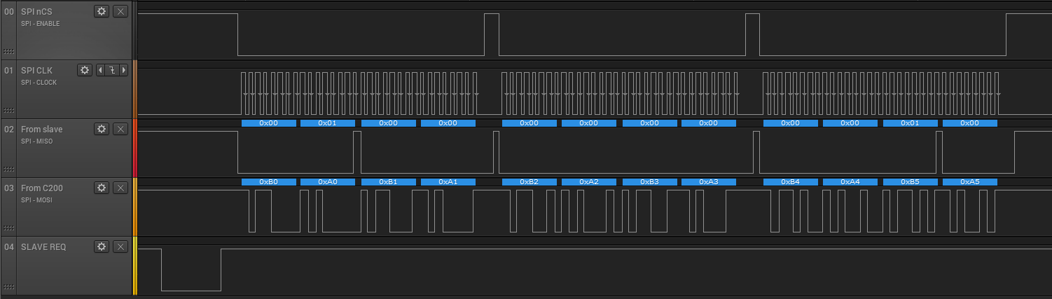

Here is the first transfer (complete):
Here is the next transfer (missing bytes):

  • Johann,
    From the LA plot, we are missing 0xB0/A0/B1/A1, which I assume is the 1st 32-bit transfer that should happen.  Also we know we aren't off the SRC addresses, since we only get 2 transmissions vs a 3 with un-intended data(garbage from an un-initialized address nearby).
    I'd like to debug this by looking at the state of the DMA address registers (both the source and destination) for channel 1 when you have disabled the McBSP TX but both before and after you re-enable the DMA by setting the corresponding RUNSTS bit = 1.
    I suspect that after the last transmission in 1st iteration the EVT signal from the McBSP to the DMA is still latched in the local DMA logic, so that as soon as you re-enable the DMA channel it attempts to write that initial word to the McBSP DXR2/1, but the McBSP has not yet been re-enabled so we miss it.  If you see the active src address = base +2 before you re-enable the McBSP then that would confirm this theory
    If we do see the above, perhaps we could change the trigger source of DMA channel 1 when the RUNSTS = 0 to something other than McBSP and then back again before setting RUNSTS = 1 to try and reset this local latch.
    Matthew
  • Hello Matthew,
    Yes, this should be the first 32-bit transfer.

  • Johann,
    Thanks for running the experiment, I believe that the cause of this issue is what I had assumed in my last post.  We have to figure out how to clear the last interrupt event(McBSP ready X-mit).  From the above changing the source is not enough to clear the latch.
    I'm going to ask my colleagues in the design team to look into how the logic is constructed here, but I'd like to try some things in the meantime so we are not stuck.  If we find something that works, we can confirm with design this is the correct/repeatable behavior.
    There's two possibilities here, depending on if the signal from the McBSP is edge or level detect.  If its edge, then we should be able to clear the latch locally in the DMA.  If its level, then we need to understand how we can reset the signal local to the McBSP.
    1:DMA register modification) Instead of changing the PERINTSEL source, let's disable the peripheral interrupt by setting the PERINTE bit to 0, and then back to 1 before writing the RUNSTS bit.  This should definitely clear any local latch in the DMA.
    2:McBSP register modification) In between transfers lets put the transmitter into reset and out of reset by writing a "0" to the XRST bit in the SPCR2 register, then re-enabling by writing a "1".  Reading the TRM I don't believe this will reset your McBSP settings.
    Matthew
