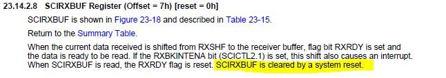

Hi experts,
Is there any way to clear SCIRXBUF other than a system reset?
The TRM includes the following description. However, our customers want to clear the SCIFFFE and SCIFFPE bits in this register in software.
My customers can't shut down the system, so they want to reset only SCI, not the system reset.
Is there any way to accomplish this?
Sasaki
  • Hello Sasaki,
    Thank you for your question. These bits (SCIFFFE and SCIFFPE) are only cleared by system reset. Please see the following threads regarding this:
    https://e2e.ti.com/support/microcontrollers/c2000/f/171/t/903529
    https://e2e.ti.com/support/microcontrollers/c2000/f/171/t/901500?TMS320F280049C-SCI-channel-reset-clarifications
    Please see the sections in the above threads about clearing the other error flags (using SWRESET bit).
    Vince

  • Hi Sasaki,
    Thank you for your patience on this. We were able to test the following sequence and determine its validity on hardware. This allows clearing of the bits discussed previously. Please let me know if you have any questions!
    SCIFFFE or SCIFFPE set, begin sequence:
    1. Read 16 times from RXBUF_SAR_M (to clear entire FIFO)
    2. FIFO mode disable
    3. FIFO mode enable
    4. Loopback enable (dummy internal loopback transaction will clear the SCIFFFE/SCIFFPE status)
    5. Write to TXBUF until FFTX_TXFFST status reaches 16 words (to clear entire TX FIFO)
    6. While TX FIFO not empty (TXFFST == 0 words), wait (for TX FIFO to empty)
    7. While RX FIFO not empty (RXFFST != 0), read RXBUF_SAR and discard data (clears RX FIFO)
    8. Loopback disable
    9. SWRESET assert/de-assert
    10. TX/RXFIFORESET assert/de-assert
