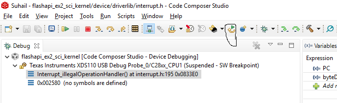

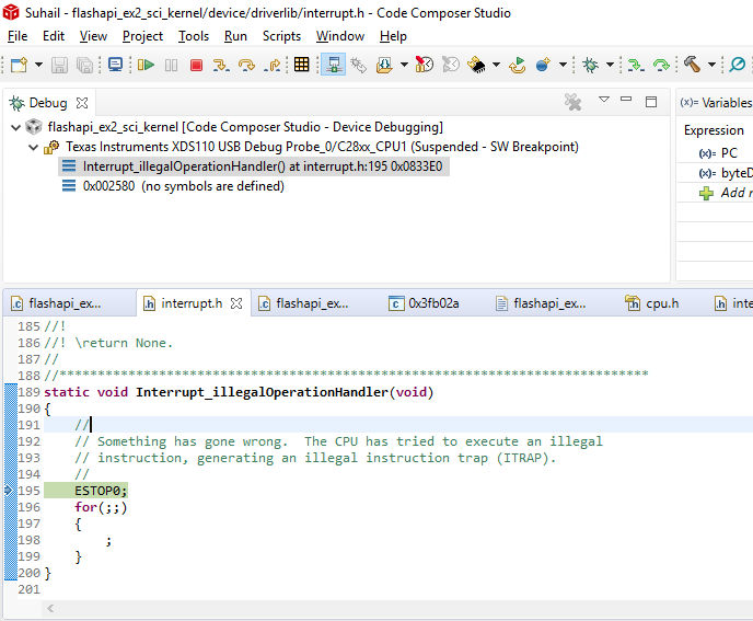

I am trying to run flashapi_ex3_live_firmware_update project for RS-485 communication. i have just made changes in the flashapi_ex3_live_firmware_update project for direction pin since RS-485 needs it. Apart from this no changes has been made. When i try to run the application it goes into interrupt illegal operational handler. See below snapshot
Can you please look into the issue?

I did troubleshooting about why it is getting into interrupt illegal operational handler i could find that, in single bank LFU we are trying to overwrite application again and again. Once after application jumps to liveDFU() it doesnot know to come back as application in flash bank has been overwritten. Hence once we reset device ,bankselct() should get executed and it will jump to new application image and execution should work fine .
But i had one observation when i do software reset by clicking restart button in ccs as shown below everything works fine.
but when i try to reset by disconnecting debugger execution does not works fine. it is getting struck while downloading image.
