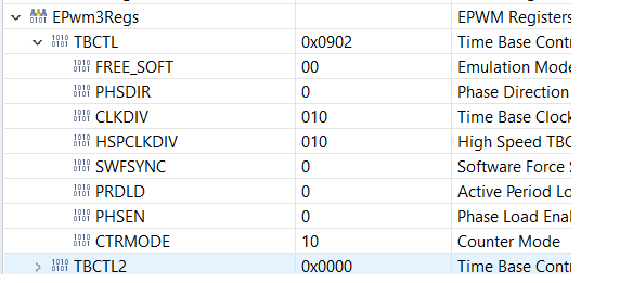

Does the time at which the debugger gets connected affect your EPWM output? If the output is high, does it stay high, and if the output was low would it stay low?
ALSO,
If you set FREE_SOFT to 0x11, would it continue to operate as expected? Since in this current mode (0x00 mode) the EPWM would get stuck at the same TBCTR value and halt the signals in their current state.
You are correct, the time at which the debugger gets connected affect the EPWM output. It means that PWM will stay high if the output was high, and stay low if the output was low.
And when set FREE_SOFT to 0x11, the PWM will continue output until they all turn off to low.
However the question is why F28388 behavior is different with others C2000 device when FREE_SOFT as 0x00 status. I have test F28377 and F280049, both they will turn PWM to low when connected debugger under FREE_SOFT as 0x00 condition. Only F28388 have issue that PWM will stay high when connected debugger.
