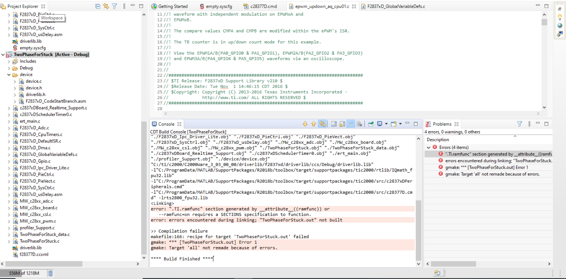

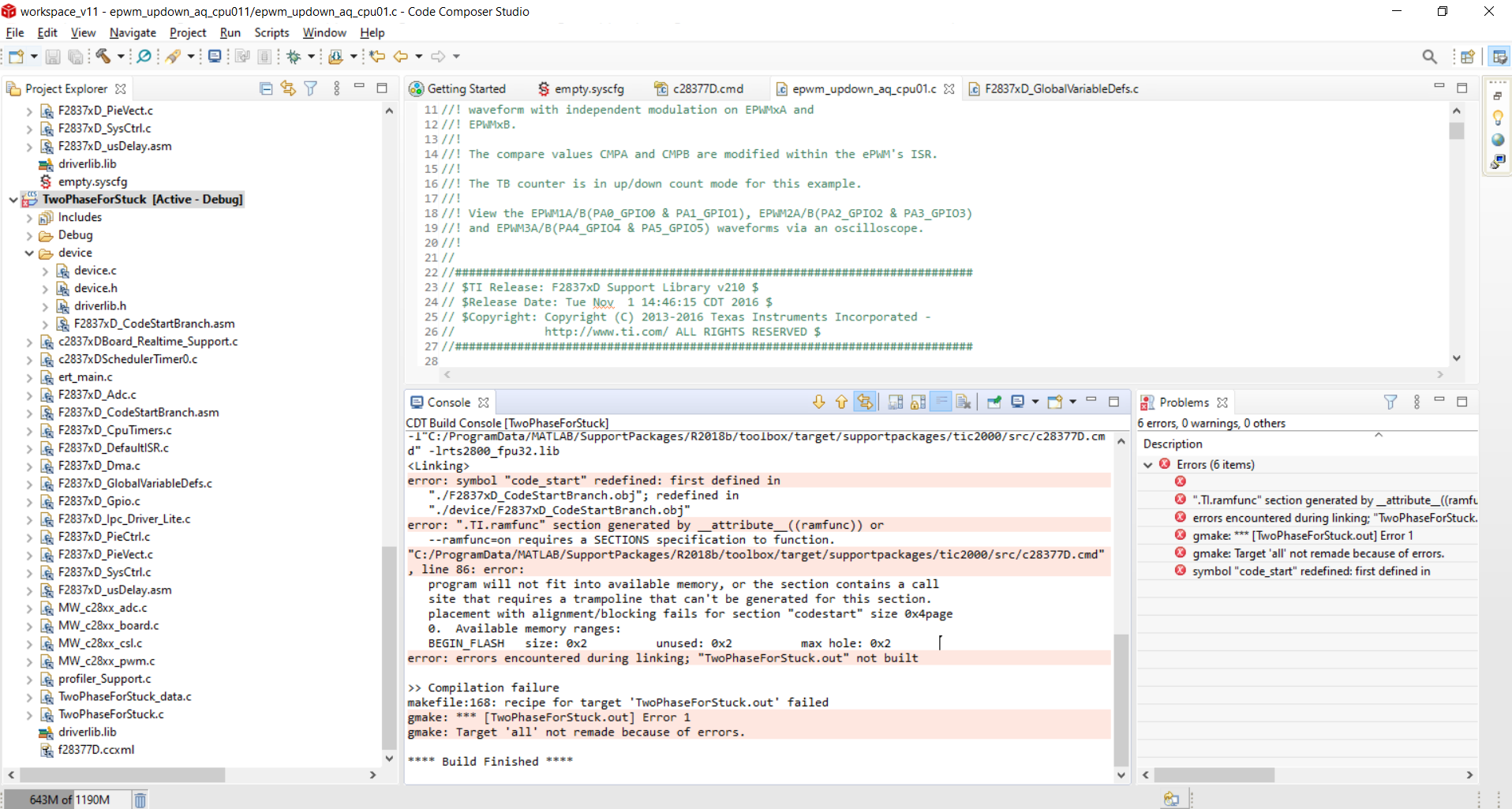

    However, I got the attached errors!
    **** Build of configuration Debug for project TwoPhaseForStuck ****
    "C:\\ti\\ccs1011\\ccs\\utils\\bin\\gmake" -k all
    Building target: "TwoPhaseForStuck.out"
    Invoking: C2000 Linker
    "C:/ti/ccs1011/ccs/tools/compiler/ti-cgt-c2000_20.2.1.LTS/bin/cl2000" --advice:performance=all --define=MODEL=TwoPhaseForStuck --define=NUMST=1 --define=NCSTATES=0 --define=HAVESTDIO --define=MODEL_HAS_DYNAMICALLY_LOADED_SFCNS=0 --define=CLASSIC_INTERFACE=0 --define=ALLOCATIONFCN=0 --define=TID01EQ=0 --define=TERMFCN=1 --define=ONESTEPFCN=1 --define=MAT_FILE=0 --define=MULTI_INSTANCE_CODE=0 --define=INTEGER_CODE=0 --define=MT=0 --define=DAEMON_MODE=1 --define=MW_PIL_SCIFIFOLEN=16 --define=F2837X_REG_FORMAT --define=MW_F2837XD --define=STACK_SIZE=512 --define=__MW_TARGET_USE_HARDWARE_RESOURCES_H__ --define=RT --define=F28377D --define=CPU1 --define=BOOT_FROM_FLASH=1 --abi=coffabi -s -v28 -ml --large_memory_model --silicon_version=28 --define=LARGE_MODEL -v28 --float_support=fpu32 -ml -DF28377D -DCPU1 -DBOOT_FROM_FLASH=1 -DF28377D -DCPU1 -DBOOT_FROM_FLASH=1 -z --warn_sections -i"C:/ti/ccs1011/ccs/tools/compiler/ti-cgt-c2000_20.2.1.LTS/lib" -i"C:/ti/ccs1011/ccs/tools/compiler/ti-cgt-c2000_20.2.1.LTS/include" --reread_libs --define=F28377D --define=CPU1 --define=BOOT_FROM_FLASH=1 --define=BOOT_USING_BL=0 --rom_model -z --stack_size=512 --warn_sections --heap_size=1024 --reread_libs --rom_model -mTwoPhaseForStuck.map -o "TwoPhaseForStuck.out" "./F2837xD_Adc.obj" "./F2837xD_CodeStartBranch.obj" "./F2837xD_CpuTimers.obj" "./F2837xD_DefaultISR.obj" "./F2837xD_Dma.obj" "./F2837xD_GlobalVariableDefs.obj" "./F2837xD_Gpio.obj" "./F2837xD_Ipc_Driver_Lite.obj" "./F2837xD_PieCtrl.obj" "./F2837xD_PieVect.obj" "./F2837xD_SysCtrl.obj" "./F2837xD_usDelay.obj" "./MW_c28xx_adc.obj" "./MW_c28xx_board.obj" "./MW_c28xx_csl.obj" "./MW_c28xx_pwm.obj" "./TwoPhaseForStuck.obj" "./TwoPhaseForStuck_data.obj" "./c2837xDBoard_Realtime_Support.obj" "./c2837xDSchedulerTimer0.obj" "./ert_main.obj" "./profiler_Support.obj" "./device/F2837xD_CodeStartBranch.obj" "./device/device.obj" "C:/ti/c2000/C2000Ware_3_03_00_00/driverlib/f2837xd/driverlib/ccs/Debug/driverlib.lib" -l"C:/ProgramData/MATLAB/SupportPackages/R2018b/toolbox/target/supportpackages/tic2000/rtlib/IQmath_fpu32.lib" -l"C:/ProgramData/MATLAB/SupportPackages/R2018b/toolbox/target/supportpackages/tic2000/src/c2837xDPeripherals.cmd" -l"C:/ProgramData/MATLAB/SupportPackages/R2018b/toolbox/target/supportpackages/tic2000/src/c28377D.cmd" -lrts2800_fpu32.lib
    <Linking>
    error: symbol "code_start" redefined: first defined in
    "./F2837xD_CodeStartBranch.obj"; redefined in
    error: ".TI.ramfunc" section generated by __attribute__((ramfunc)) or
    --ramfunc=on requires a SECTIONS specification to function.
    "C:/ProgramData/MATLAB/SupportPackages/R2018b/toolbox/target/supportpackages/tic2000/src/c28377D.cmd", line 86: error:
    program will not fit into available memory, or the section contains a call
    site that requires a trampoline that can't be generated for this section.
    placement with alignment/blocking fails for section "codestart" size 0x4page
    0. Available memory ranges:
    BEGIN_FLASH size: 0x2 unused: 0x2 max hole: 0x2
    error: errors encountered during linking; "TwoPhaseForStuck.out" not built
    >> Compilation failure
    makefile:168: recipe for target 'TwoPhaseForStuck.out' failed
    gmake: *** [TwoPhaseForStuck.out] Error 1
    gmake: Target 'all' not remade because of errors.
    **** Build Finished ****
  • Remove the CodeStartBranch.asm file.
  • I am feeling embarrassed by keeping asking you and I do appreciate it!
    I removed the CodeStartBranch.asm file from the project file but according to the link I sent above I should keep the  CodeStartBranch.asm file under the device folder. I did, however, rebuild the project for the two cases and I got these remaining errors: reduced to 4 errors
    <Linking>
    >> Compilation failure
    makefile:166: recipe for target 'TwoPhaseForStuck.out' failed
