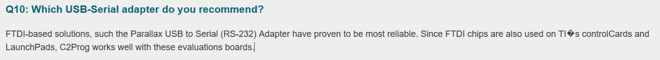

  • I would like to bring your attention to the below in https://www.codeskin.com/c2prog-faq

    By C2Prog, bootloading is OK but connection failed afterwards. But I think I found at least one problem. Our board has a 37.5Mhz frequency and should use 38400 bauds. Since C2Prog does not have these settings it makes everything complicated.
  • OK, looks like JTAG option is ruled out and serial port is the only option. You may want to reach out to Codeskin and explore if they would customize the serial loader for your clock frequency.
  • Thanks Hareesh,
    I tried yesterday something that I thought I already tried. Since SDFlash only looks at COM until COM4 and my USB adapter was recognized on COM8 on the laptop, I forced COM4 for USB adapter and tried again to flash.
    This time it worked. Thanks for your help.
